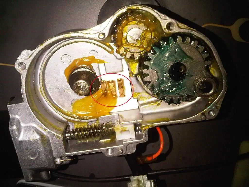

First thing you need to do is remove the plastic cover by pulling on it carefully. Don’t hang from it like an ape, look for the clips that hold it. There’s 2 on each side and one that goes into the wiper plate if I recall correctly. Next you’ll see the wiper assembly backplate. It held by 2 nuts to the latch and 3 screws to the assembly. Take those off and this is what you’ll see.

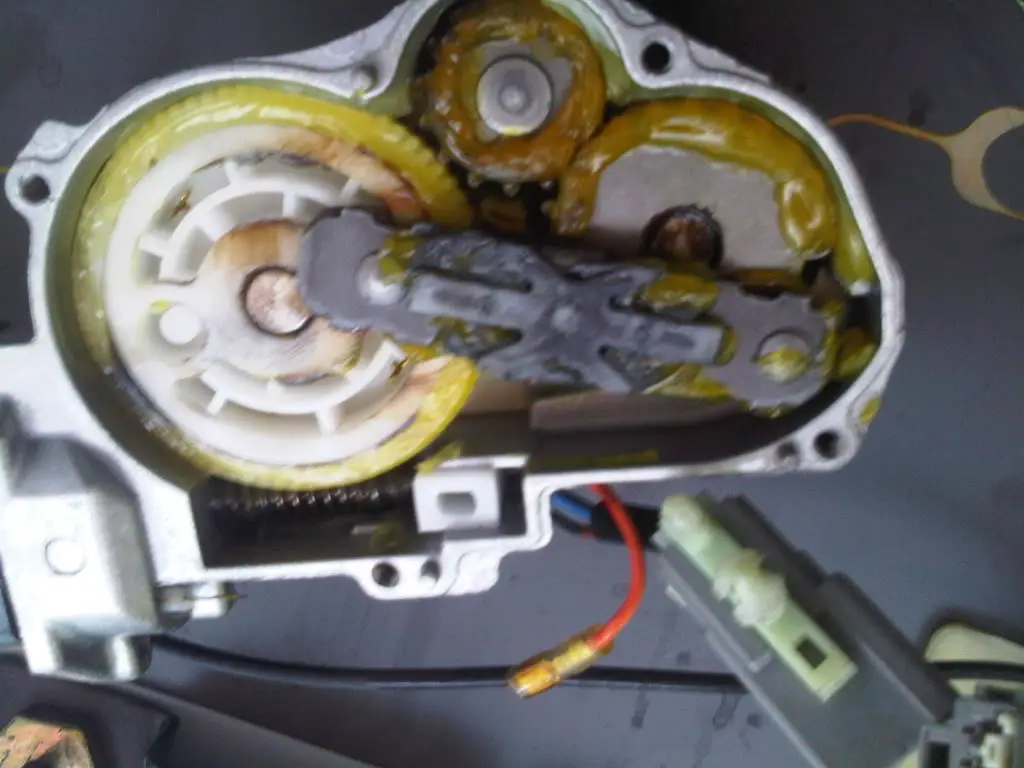

This is where it starts to get messy. Behind the big white sprocket there are 3 electrical contacts for the motor as well as on the back side of the sprocket. This is what makes it go back and forth by reversing the polarity on the motor when it gets to a certain point.
I couldn’t take a pic of it, but it was very dirty with carbon deposits. I wiped the whole thing clean and re-greased. Because of the carbon deposits I assumed that the carbon contacts on the motor had worn out and that’s why it wasn’t moving.

At this point you’ll want to re-lubricate everything and put it back together. Make sure that the area with the cutouts on the electrical tracks of the sprocket line up with the electrical contacts, as well as having the wiper arm on its resting position (towards the driver’s side of the truck).
