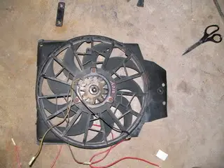

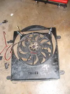

Part 1- Prepare electric fan
a.) Trim down Taurus fan
The electric fan and fan shroud in the Taurus are all one unit. The fan shroud in your explorer will not be discarded. The fan shroud of the Taurus will be trimmed down, and installed into the fan shroud of your explorer.
This is the electric fan/shroud straight out of the Taurus:
You will want to trim down the Taurus fan/shroud combo to somewhat closely resemble what I have done in the photo below:
The more narrow portion of the fan shroud (right side of the photo) will be mounted to the bottom half of the explorer shroud. The wider portion (the left side in the photo) will be mounted to the upper portion of the explorer fan shroud. As can be seen in the photo above, drill two holes close together near the center on the narrow side (right side in the photo), and one hole in each corner in the shroud to the left. These will be used as the mounting points.

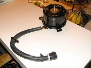

NOTE: These Taurus fans are very reliable and pull lots of air however, since your fan will most likely be 10-15 years old, it is a good idea to spend the $90 to replace the motor. My electric fan motor failed since it was 16 years old so I have replaced mine and have had zero problems since.
The fan blades are removed from the motor spindle by the clip up top and slides off like so:
The motor is held into the shroud by three mounting bolts on the back side. This is what a new motor is like:

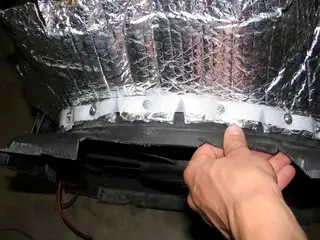

d.) Prepare a heat resistant material to complete the shroud
As you can see in the photo above, there is a good sized gap right above the fan and the explorer shroud. This must be covered up. Otherwise the fan will not function as efficiently as possible and air will recirculate through the fan through the gap behind the radiator, resulting in diminished air being pulled through the radiator.
This was my solution:
I don't know what it is, but I found that foil/plastic material in the garage and cut it to the above shape and screwed it into the fan and fan shroud with a plastic band for more security like so:
NOTE: in order to install the fan into the truck, the upper portion of the explorer shroud must be removed and reassembled after the fan is installed.

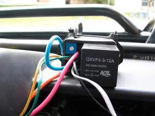

a.) Install Hydan control unit or another fan controller you wish to use.
Install the Hyden controller on the left side of the above the radiator on the plastic beauty piece of plastic. Drill two holes and install with a zip tie like so:
There are multiple wires going out of the fan controller:
-wire to A/C compressor clutch (when the A/C is on, the Hyden controller turns the fan on and keeps the fan on as long as the A/C is on.)
-wire to battery
-wire to fan
-probe to radiator
-wire to hot ignition wire.

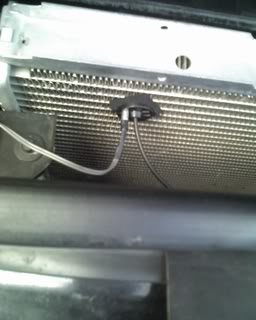

Run the wire from the controller to the battery. Now run the probe into the radiator into the top left hand side like so:
You want the sensor to read the temperature of the coolant going into the engine, not out of it. The temperature of the coolant coming out of the engine will always be around 195, because of the thermostat. This way the controller will only turn on the fan once the sensor probe reads a temperature of around 195, signaling that the radiator is currently cooling the the maximum that is allowed by the air flow through the front end.
The lead to the A/C clutch positive wire can be found next to the large wire connector next to the battery tray. The large wire harness connector to the left of the battery in the photo.
The wire to splice into that goes to the compressor is the gray wire that is striped with a white line. In the picture below the wire with the blue splice crimped onto it is that wire. The flash whites it out but it is gray and white:

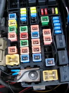

Now for the wire from the controller to the ignition power, open up the power redistribution box under the hood and look for fuse #39, this fuse is for the fuel pump and is only hot when the ignition is turned to on. Pull this fuse out, stick in the ignition lead wire and place the fuse back in like so:
I know its red-neck, but it works.
This ignition wire is necessary so that the fans do not run when the engine is off.

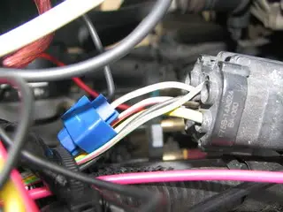

Note: The hyden fan controller can not handle the amperes that the Taurus fan draws while on hi speed. The hyden controller can only handle about 30amps, therefore the power wire coming out of the hyden controller for the fan will be connected to a 40amp relay. The fan reportedly draws up to 70amps just for a millisecond on startup, and holds steady at about 35amps on high speed.
Note the three wires coming out of the Taurus fan. Black is ground, and the larger wire in diameter is for high speed and the thinner wire is for low speed. Cut off the connector at the end. The 10 gauge wire is necessary for all three wires on the fan. Use the 10 gauge from the ground on the fan to the body of the truck and 10 gauge on each low and high speed wires to their respective relays, and use 10 gauge wire from their respective relays to the battery. Otherwise a smaller wire in diameter can be used for all other wiring.
Note: The hyden controller is also a on/ off controller, it does not vary the speed of the fan at all. In order to utilize both speeds of the fan, install a 40amp relay to both the low and high speed wires. Wire the power into the relay from both to the battery, each with their own inline blade type fuse. Use a 40amp fuse for the high speed and a 35amp fuse for the low speed. Now connect each of these relays to a Single Pole Double Throw relay that will be wired to a switch on your dash to switch between high and low speed. Now instead of wiring the wire out of the hyden controller directly to the fan, wire it to the hi/ low speed power in section of the relay. The fan will short out if it is powered by both the high and low speed wires at the same time. As can be seen in the diagram below, the SPDT (Single Pole Double Throw) relay is used to switch between the two speed wires to prevent this problem from happening.
Here is my wiring diagram:
Diodes are necessary in order to prevent shorting out the life of the relays. When the fan is off on the highway, it freewheels because of the wind and send back electromotive force back up the wire (essentially acting as a generator). This back EMF (electromotive force) can shorten the life of the relays. In order to counter this, two diodes, one on each positive wire into the motor, is used to bleed out the back EMF to the ground.

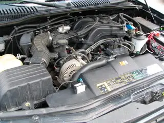

I wired all the relays close to the battery. Here is the mess in the end:
That photo is with the relays sticking out. Otherwise they all hide away nicely underneath the plastic piece they are laying on in the photo.

My secondary exterior "for off roading purpose" head lights.
I connected them to the power on the fuse box because I already have too many wires coming out of the battery terminals.
