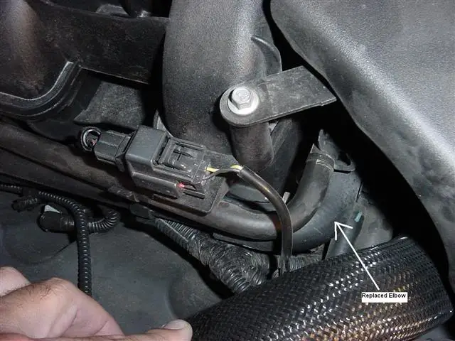

Any "check engine" lights or code? The IAC valve and the front PCV tube elbow are trouble points on these trucks. You can clean the IAC to see if it helps. Check the underside of the PCV elbow(that's where they split) but it usually throws a lean code when bad. You won't hear any hissing.......

But when I'm driving down the road it's fine.....runs smooth.....at idle 600rpm don't really feel it.... in gear or not don't....1000 to 1500 you feel it....now if I tack it further maybe a little rough hard to tell.....I did check all the hoses all good.....I will check the PVC....I'm hoping it's not internal because it only 62000 miles....This wasn't a gradual thing it just happen 3 days ago out of the blue.
