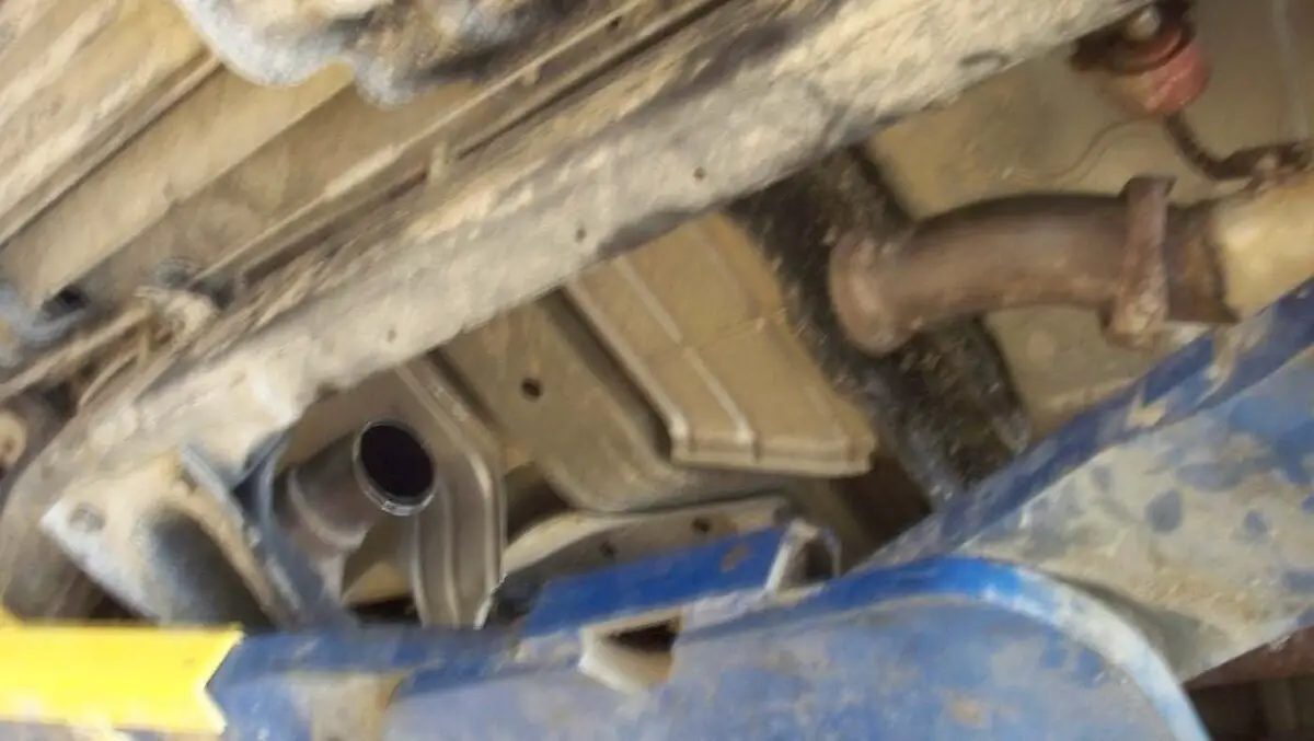

the pipe that I put in was 2.5" I am thinking about redoing the entire exhaust with 2.5" or 3.0" but that is only an idea at this point. I definitely recommend leaving the cats alone. The bigger the pipe, the lower the sound. Do not dump it, though, as that just leaves the gas under the car to come up into the car. It has been proven in a test by Caldwell. Something you can do, however, is relocate the tailpipe to in front of the rear tire, but that is up to you. If I can figure out how to post sound clips I have one of my exhaust as it sits. But here are some pics:
Where I cut out the spark arrestor:
(left is to cats, right is do rear)
Replacement pipe:
(straight end just goes into hole to cats, other end bolts on)
Finished and installed:
Again, by unbolting this pipe, I can remove it in about 5 minutes, and completely change the sound of my car.

Kstrayhorn,
where is your exhaust exiting ?
pic ?

the first pic above, it is exiting out of the left pipe. I do have a removable piece pictured in the second and third pics, which allow it to run all the way out of the tailpipe. When i have that piece removed, I roll with all the windows down and the a/c running.
