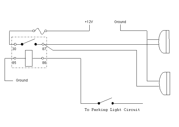

So i bought an aftermarket set of fogs (standard set of carquest 50 buck fog lamps) for my x. I direct wired it into the parking lamps wiring (Problem number 1, i should of researched) got it all wired up, was thrilled to see it light up and work. Kept checking fuses for heat and such. No problem. Drove to a friends house a half hr away to show off my job (I thought i was pretty trick at this point, feeling good, proud to have fog lights not controled by my fog relay (Second mistake, my brain shoulda said Dumba** dont f*** with a good design)
Pull into his house, he comes out, shut off truck, auto headlights keep things lit up, we comment about it he thinks its a pretty neat setup. Lights shut off, we bs some more. Dark falls, so i decide its time to aim them, reach in and flick my headlight switch to parking lamps, nothing, no parking lamps, no dash lights, no ding, no back lamps. OK! check fuses, check fuses, check fuses, find a blown 15 amp fuse in the power distro box in slot 11 on the mini fuses. Swap with another fuse, go back to dash (Mind you i have the side fuse panel in dash popped from the great fuse check of 2010) flick the switch to parking lights, the lights are dim. WTF? come back around, look and see from the front, no fogs, dim tail lights, dim license, dim parking lights. Im on the phone with 96 Ford Tough at the time commenting, go back around to my truck to shut the switch off and i see faint wisps of smoke come out of the dash, thru the space between my fuse panel and dash. !!!!*&#*#$(*(*#$@(*#$@!!!! (to name my language), shut lights off, parking lights wont shut off. *#*$((#*@&$(@#!!!!! yanked the auto headlamp plug in the rearview mirror, still on, start panicking, truck still smoking a bit, yanked the #11 fuse again and it shuts off. *HUGE SIGH OF RELIEF* so calm down, light a cig (odd, i want to smoke after my truck does) start checking fuses, find a few blown fuses, (Starting to think maybe i was a total moron at this point), reinsert the #11 fuse with the truck off, all switches off, parking lamps come on and wont shut off *HUH?*. start checking everything, ended up tearing apart lower dashboard, pull headlight switch out, its fine, wires are fine, pull fuse box out, as far as i can see, all the wires in are fine, getting really confused as of this point.
As i sit right now, my baby is sitting at my friends house, im sitting in a Kia Rondo at work (I HATE the killed in action) now trying to google and figure out whats wrong with my truck. Ive discovered it could be anything to a burnt wire, a burnt relay to i may of cooked my PCM ** hoping to find out whats wrong and open to ideas.
