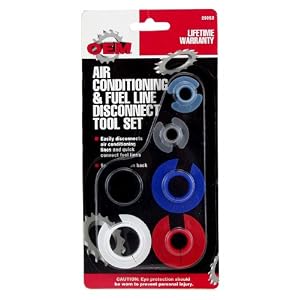

Pick up this set from Autozone. You will use either the gray or the baby blue. KEEP FIGHTING WITH IT!

Forget the plastic ones.....and the sissor type. Just spend a little more for these:
Pull that cable away from the filter; slide the correct one of these on;push that line back towards filter while pushing the tool into connector;work it in with a slight little spin of the tool and that line should come right off.
Good Luck!

In my experience any of the tools made of metal do not work as well. With the plastic tools, you can really jam it in there, whereas metal only goes so far.
