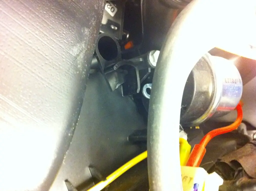

Mine has this problem too. You might try this thread. http://explorerforum.com/forums/showthread.php?t=249624 I haven't tried this method yet; still thinking of possibilities.
Here's what you're looking for. This is looking where the glove box door was.
This is moved in a little
Notice where the black piece of plastic broke off
jetjockey352 is offline   Reply With Quote

I looked in there and checked it's operation and it moves fine. But doesn't shoot much air out of the floor vents when it moves to that position.

There are 2 of those actuators if you have the rear vents. The second is hidden by the console, just below the one pictured.

Well, after tearing into mine tonight I found that mine was broken like the pictures above. The whole piece wasn't broken, just the tab that the metal piece attaches to. I drilled a hole in it and safety wired the two together and it seems to be working now.
