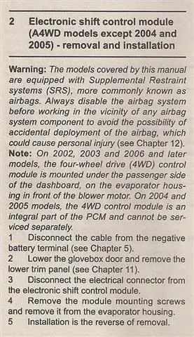

On the '04, the 4x4 CM is part of the PCM & can't be serviced separately.
From my Haynes Manual:

Not sure you want to hear this but :
SECTION 308-07: Four Wheel Drive (4WD) Systems 2004 Explorer/Mountaineer Workshop Manual
REMOVAL AND INSTALLATION Procedure revision date: 10/28/2003
Four Wheel Drive (4WD) Control Module
The four wheel drive (4WD) control module is integral to the power train control module (PCM) and is not serviced separately. For additional information, refer to Section 303-04A for 4.0L engine or Section 303-04B for 4.6L engine.
Ahhhh, the BigRondo beat me to it!

You're welcome! Can't really say about reliability of the '03-'04's. They went back to a separate module in '06-'07. Don't know if the later years also have a separate module.
