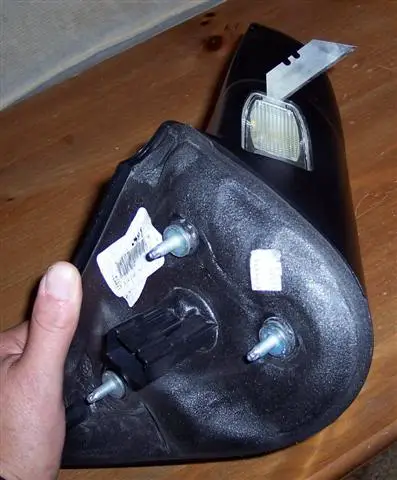

It is possible that something got wet from the carwash. Check if you have water in the puddle lights:
Insert utility knife blade at point shown. Be very careful so you don't cut yourself. Some have used a small, thin screwdriver. Push blade up and away from vehicle and lens will pop out. Then twist lens off socket. You don't have to remove the mirror to do this. I had the mirror off to add turn signal mirrors.
