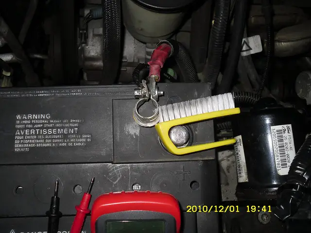

1. Start by disconnecting the Positive (red) battery cable from the battery and separating them so they do not make accidental contact. The terminal is held on by one 8MM bolt.

May I add that using the multimeter to confirm voltage (when battery is still connected) at the blower plug is also a good idea. Then check continuity at the plug.
Also as a quick check, you can run power to the blower motor from the battery and ground to the car to see if blower motor itself works.
My issue was the #30 slot on the blower motor relay. The plug and wire fell out of the slot causing no connection with the relay. I was getting 12.5V at the blower when grounded to the car. Nothing in the plug before fixing.

20. Check continuity from High speed blower relay Pin 87 receptacle to the Negative battery cable.
Picture 20a: From High speed blower relay Pin 87.
Picture 20b: To Negative battery cable.
Were all the continuity checks good? Are all the fuses shown above good? If so and your Blower motor does not come on when the Blower motor switch (in center console) is placed on HI with the ignition in RUN. Then you need to start troubleshooting the Blower motor relay, Blower motor, and High speed blower relay. The Blower motor resistor is not a part of the circuit in that configuration so it can be ruled out. If the Blower motor switch is placed in any position besides HI the Blower motor resistor becomes part of the circuit.
If a continuity check came back negative repeat it to confirm your results. If it is still negative you are probably looking at a broken wire or loose connection. Where the wires connect to relay box and fuse panel receptacles can be an issue. If the connections at the relay box or fuse panel are just loose you can try re-seating them and securing them in place. If the terminals of the wires are not the issue then the wire itself may be broken. Fixing that will require running a replacement wire of the proper gauge and disconnecting the old faulty wire. I will not go into that because people of proper background should be able to figure it out and each case will be different.
