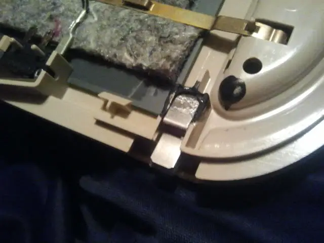

i helped someone on here in the past with the same problem, i resolved it by glueing the plastic back together
__________________
Mods:
265/70/17 ; Tow Hooks; Telescoping Steering Wheel; Kenwood DDX616; Class III/IV Hitch; Custom 2nd Row Center Console
College Student is offline   Reply With Quote
Old 02-02-2012, 09:08 AM   #8
College Student
Indinapolis, IN
'03 EB
Join Date: Sep 2010
Posts: 1,362
Vehicle Specs
Mentioned: 0 Post(s)
Tagged: 0 Thread(s)
Quoted: 37 Post(s)
basically take the lights out
then unscrew the two screws holding it in
then repair the area around the little metal hook looking thing
what happens is the plastic cracks then it doesn't lock the door closed
repair the plastic then it clip cant jump past the crack
the vanity mirror door cover will now hold itself closed again, and
not just swing open
