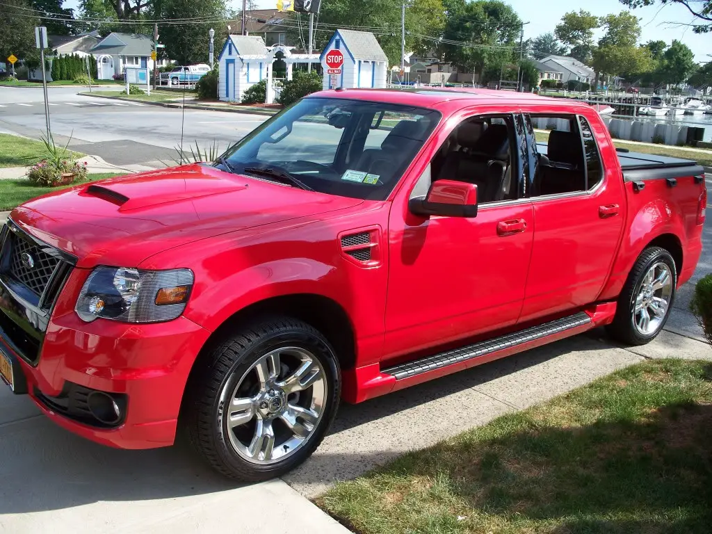

here are the pictures :
That thing is sweet!! :eek:
thats good lookin man, ya need some bigger rubber thou
Do you think the 4th gen headrests will fit in a 3rd gen? I have a 2004, and am looking for a 06+ headrest...
That is a sweet truck right there. Nice find on the headrests, too. It would be cool to see a before hand picture. :p:
