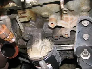

I was wrong
I was just under my truck replacing the rear differential oil when I thought I would check out that engine oil leak again. I remember you mentioning the oil filter mount so I thought I would check it out again. Upon initial inspection it looked dry, but upon further scrutiny I found oil above the upper pan and on the block itself, higher than the pan gasket or rear main seal. I took off the exhaust manifold for continued inspection and sure enough, the filter mount is the culprit.
I owe you a beer!
Unfortunately I also found on the forum that there is a TSB about this problem too where the filter mount leaks due to porosity and not the gasket. I may have to go find myself a new mount if I find that to be the problem.
I'm going back out to the garage now to drain my oil pul off the filter mount.

Oil adapter PN
I'm glad that you found the source of your leak! I checked the PN listed in the TSB against the Ford database ($67.56 MSRP or $33.44 online) and it only applies to 2002 thru 2010 models. I would have replaced my gasket when I had the engine out for the timing chains but I knew I would be pulling the engine again before long and there were no signs of it leaking. Be certain the valve cover above the oil cooler adapter is not leaking onto the adapter.
Thanks for looking up the part. Upon inspection of the mount after removal I discovered that the o-ring between the engine block and mount was flat with the mount itself, making me wonder how it even sealed at all. I also did not find any evidence of cavitation inside of the mount.
I went to O'Relieys and found a new o-ring for $6 that fit and is much more plump that the last one. The new ring also extrudes from the filter mount surface too. Hopefully it should no longer leak. The old o-ring probably shrunk and got a bit brittle from the engine heat.
