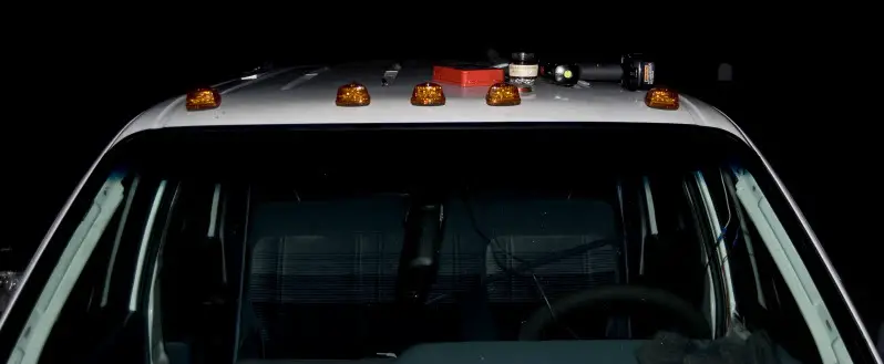

Where are the lights mounted?
do you have a pic?

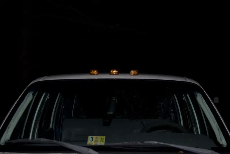

i still need to mount the other two, but with limited daylight when i get home and the horrible pain in my knees from kneeling on the hood to do this slows me down
wires will run inside the window reinforcement area(i guess thats what it is) and down the passenger a pillar, to relay and then to aux fuse box either under seat or in the center console

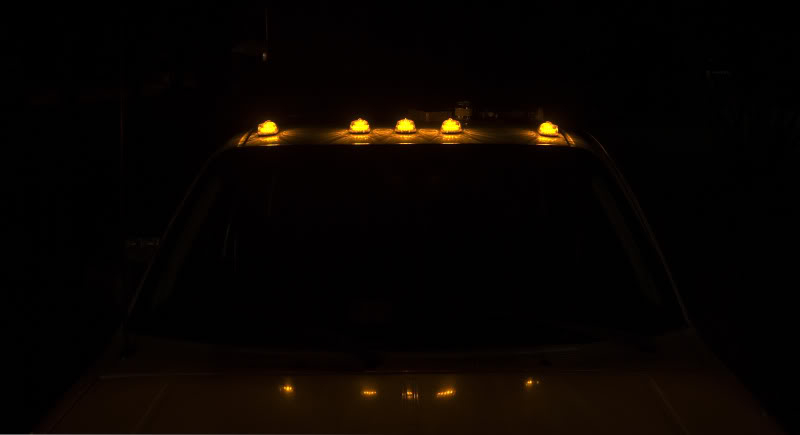

cool. ill try and install the other two tonight and wire em up for a pic then.
