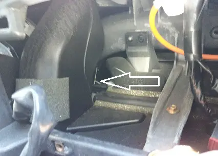

I also have a problem with where I direct the airflow. I already fixed my temp mix adjustment by replacing my blend door actuator. I used to think that the defrost just didn't work as good as previous Explorers(1st & 2nd generation), but one day I realized that I always have airflow at the windshield defrost and floor when on ONLY floor or ONLY defrost, ther is no change in flow intensity. I looked into it further and pinpointed my floor/defrost door vacuum powered actuator linkage. I was wondering if anyone had any tips on how to fix the linkage, and if I really need to remove the whole dash to get to it. I see the broken black plastic linkage behind the radio and near the instrument cluster. In the pic below you can see the track of the radio. The broken linkage is just to the right-rear of the radio.
Thanks for any ideas or tips if you have tackled this one before! I am hoping I can get to it better if I remove my radio and instrument cluster this weekend. Wish me luck!
