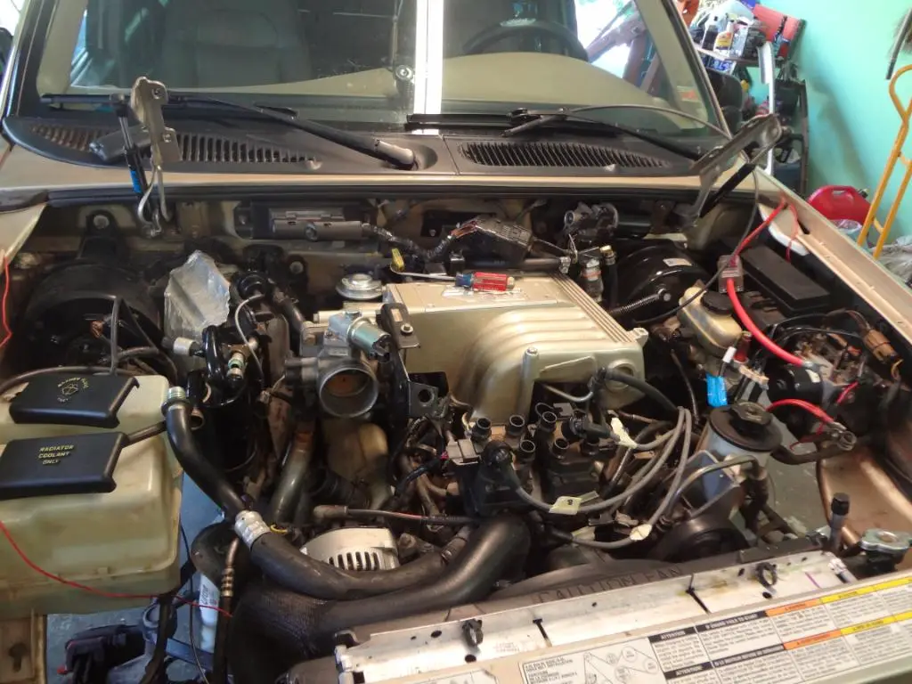

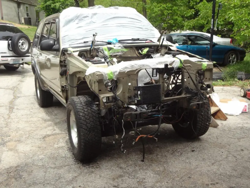

Well guys , I'm gonna start tearing down the truck tomorrow. Wish me luckl. Im still waiting for the heads and lower intake to get down and I also have a beehive Spring kit coming from Flowtech Inductions. Still waiting for Ed to build my camshaft and select my rocker arms. Do you guys think with this beehive spring kit, new rockers, cam, and ported and milled 0.018'' GT40p heads I'm going to need new pushrods, lifters for this or will I be able to retain my factory ones? I'm not planning on changing the bottom end of the motor outside of new seals, gaskets, pumps, rings, and bearings.

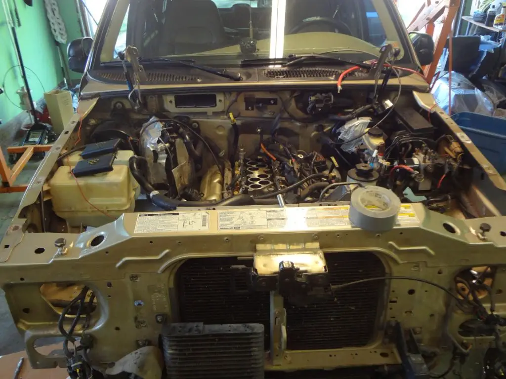

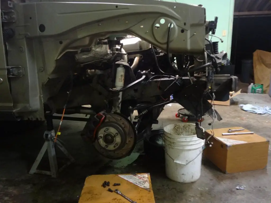

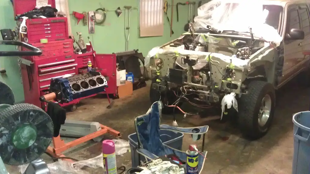

Engine teardown is officially underway. Boy I tell ya, as clean as my engine bay was at the surface it sure is dirty the lower you get. I also discovered I was leaking a little bit of oil from the valve cover somewhere it seems. Also, it's amazing even with the fenders off how hard the TMH bolts are to get off. It's been an experience thus far. Should have it pulled tomorrow hopefully. I'm still waiting for my heads, lower intake, and spring kit. I still have to get the general overhaul parts, rockers, and cam, and a few other things. That's gonna take about 2 pay periods atleast. I'll keep people posted and welcome any info that could be useful.

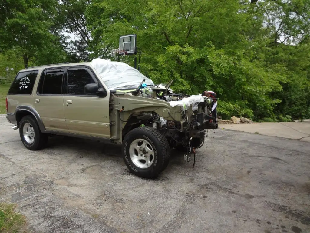

Lol yeah we're both crackin down on it. And yup you sure did lol. We got quite a bit done tonight. Loosened the header bolts, removed the plugs, the PS Pump, A/C Compressor, fuel rails, and alot of the stuff up top. Hoping to get the exhaust completely off the motor tomorrow, remove the starter, Bell housing bolts, radiator, fan, and a few other things and she should be lifted out by tomorrow night. I'd say going at a normal pace the engine should be disasembled by the end of the week.

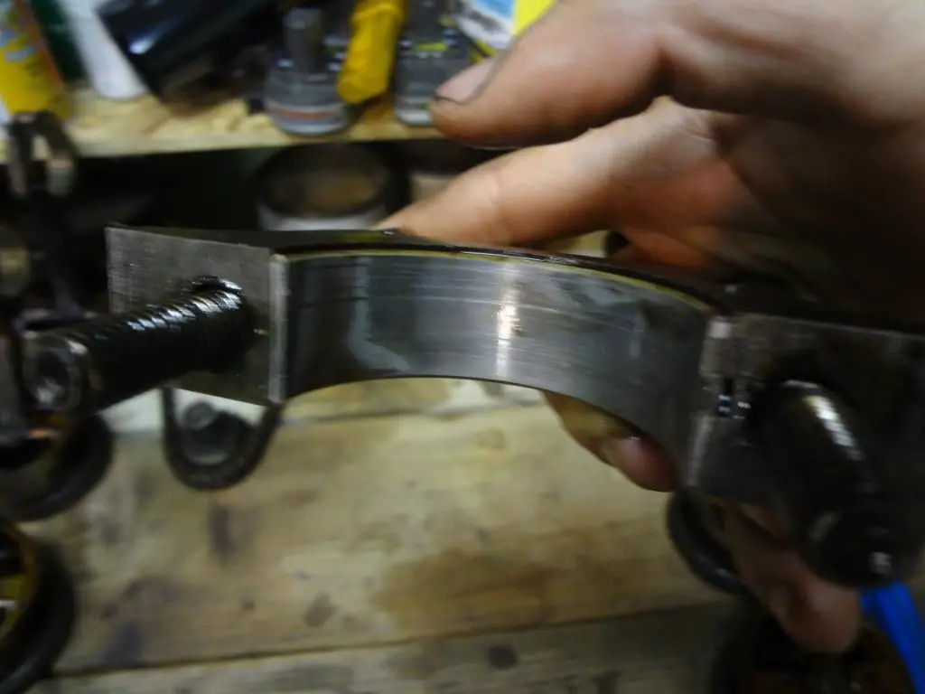

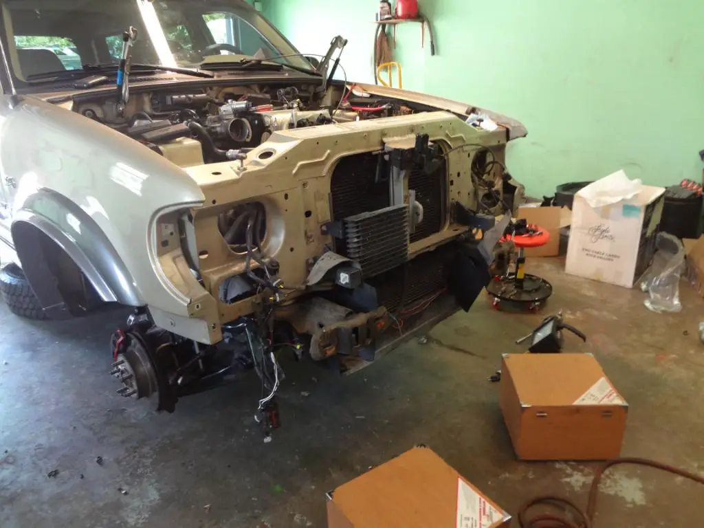

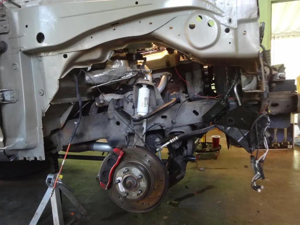

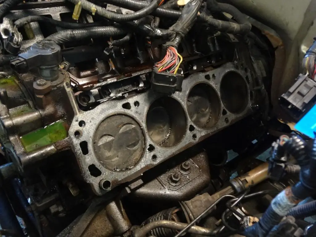

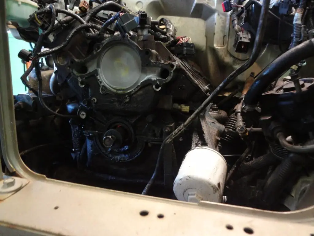

Got a little more work done today. Got the water pump, radiator, one of the headers off, drivers head, lower intake, and the harmonic balance. While trying to take that off there was so much dirt/oil buildup on it from the front main seal leaking we couldn't see the holes for the puller bolts. We tried a different method and ended up chipping the end of the pulley So next week it's off to the pull yard for a new harmonic pulley. So Jon now you don't have to feel bad for that cracked manifold tab But I will say that most of the valve cover bolts were barely any tighter than finger tight! Whoops, that may explain the oil stay in the ridges of the covers and that hot oil smell I'd get after getting out of the truck sometimes. I'm gonna price a new Harmonic balancer first before trying the pull yard. What size balance is our 302? Autozone wanted a couple hundred. E-bay is showing brand new ones for under $100. http://www.ebay.com/sch/i.html?_nkw=....c0.m270.l1313
Overall that's the first main set back so far. Still waiting to hear from my cam builder on that and still need rocker arms to have all the after market parts that I'll need for this.

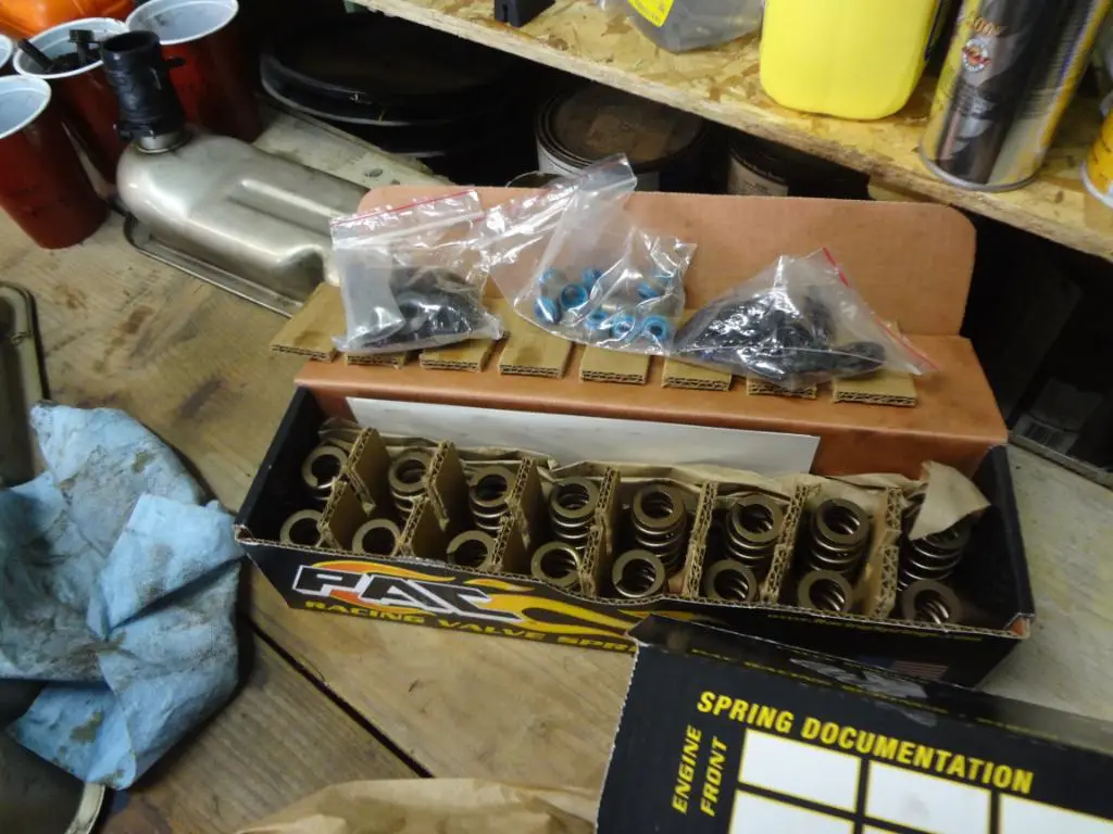

Oh yeah, also got my PAC Racing Valve spring kit today.
Beehive Valve Spring Kit #1XL: $495
PAC Racing 1518 Beehive Nitrided Valve Springs
.650” Lift Capable
130# at 1.800”
318# at 1.200”
Weight: 75 gr.
Chromemoly Steel Retainers
Hardened & Machined Valve Locks
Hardened & Machined Locators
Steel Shell Viton Valve Seals

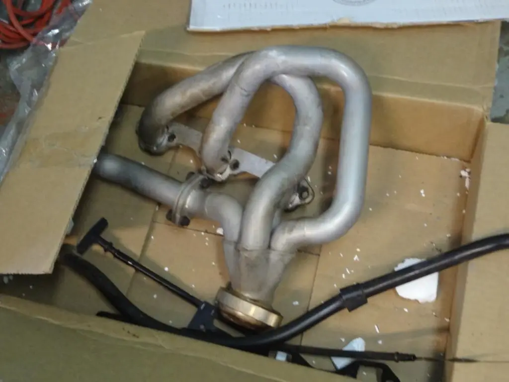

Speaking of which, Anyone know of anything that might restore the polish of the headers?
Ouchies~!

Real Fine steel wool and a cleaning compound which is not aggressive. Clean all the residue off real good with a clean towel. This should brighten them up a bit.

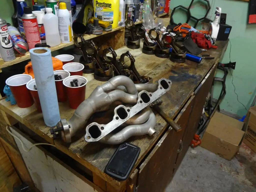

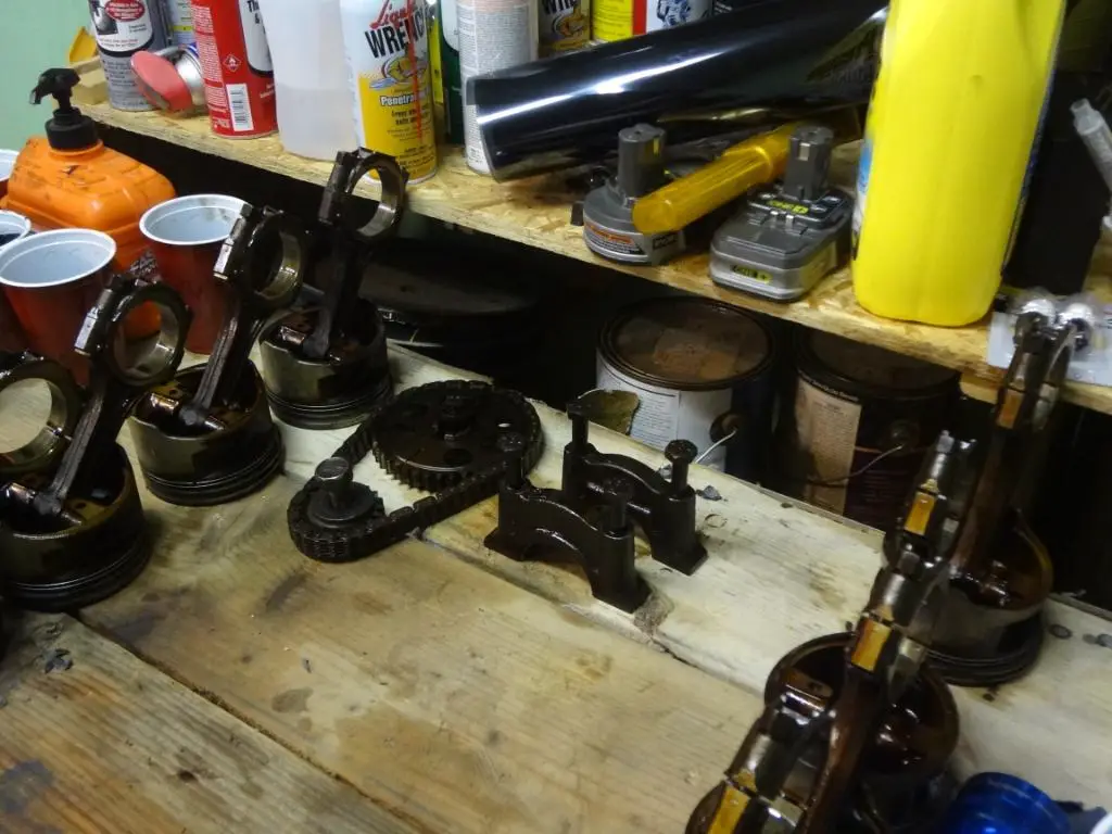

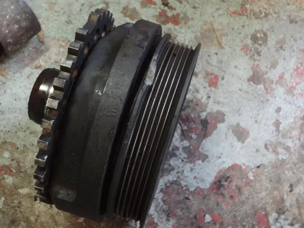

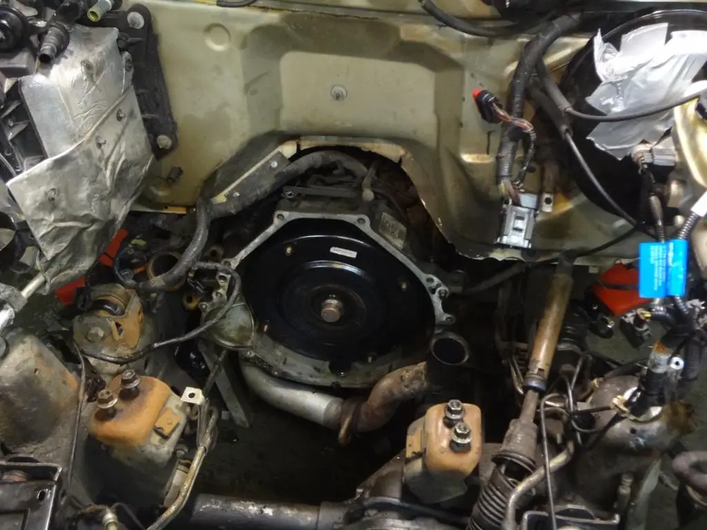

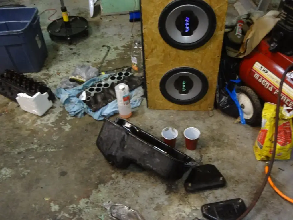

Quick update motor is finally out. It's on the stand with the pan still on it. I'm gonna go out and drain it here in a bit then start cleaning the engine bay, the block&Pan and lower suspension. THere's oily grease and dirty everywhere. I had an oil leak from both main seals apparantly. Oh and Jon, I seen there's a little bit of rust on the collecter flange of the headers. Is there any paint that can be used to withstand the heat from the headers. I was thinking of painting them black now since I seen that.

Try some aluminum foil, dip it in coca cola and scrub the rusty spot--
Other than another ceramic coat, nothing will hold up

Ok, On Monday I'm going to try to get all the parts bought to rebuild the lower end of the motor since I still don't have my heads back yet and still haven't heard back from flowtech about my custom cam. Oh yeah, were ya able to get Eric's Harmonic balancer off yet?

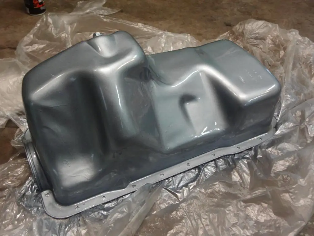

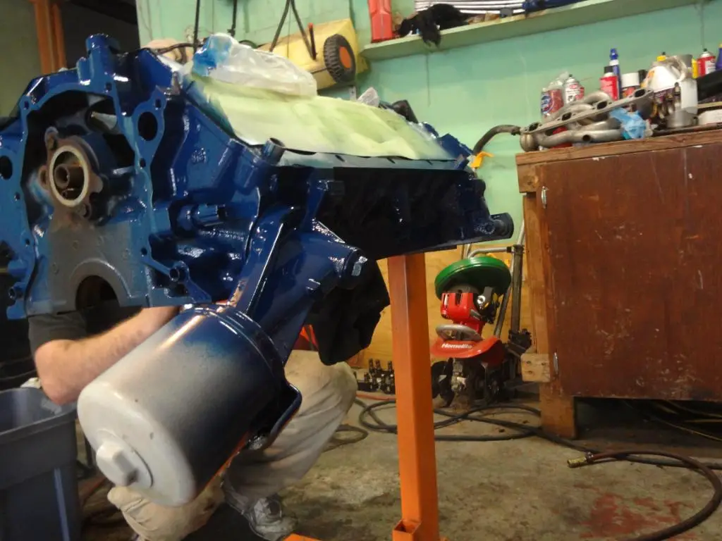

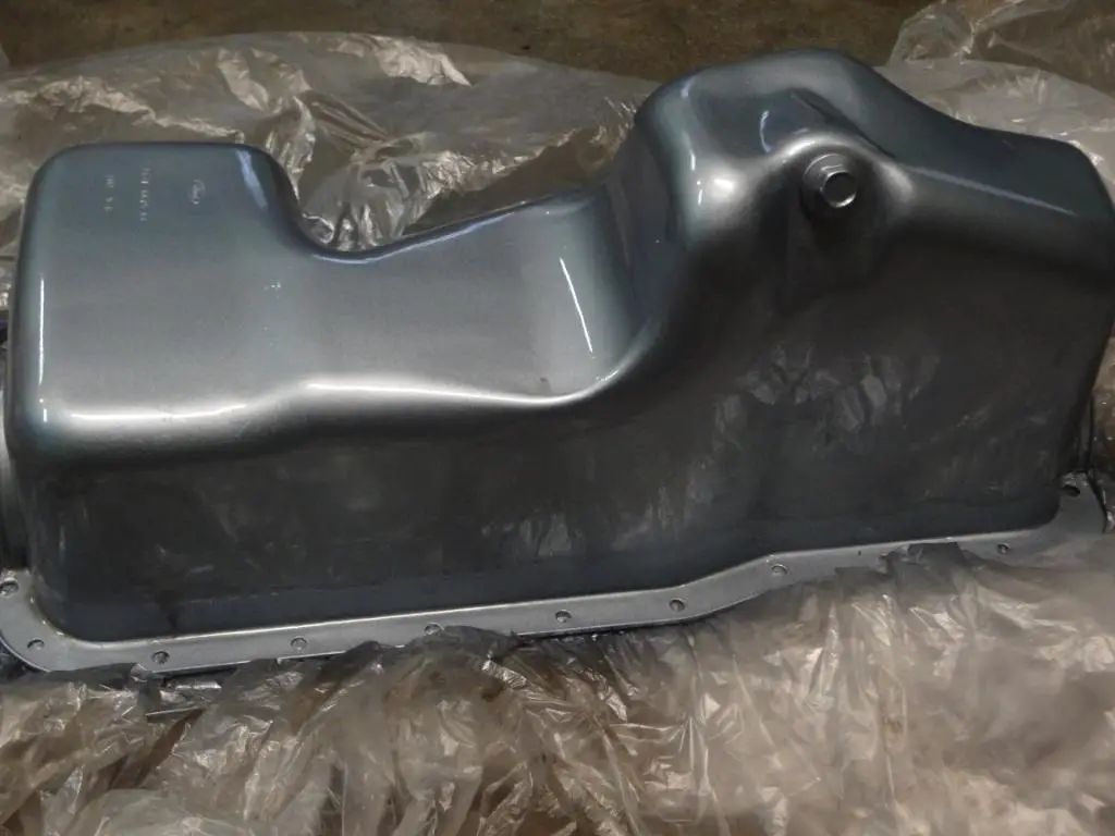

Got some work done...
Yess there's some runs in it. I'm not worried about ABSOLUTE perfection on something hardly anyone will see. But this does make it look better than before
