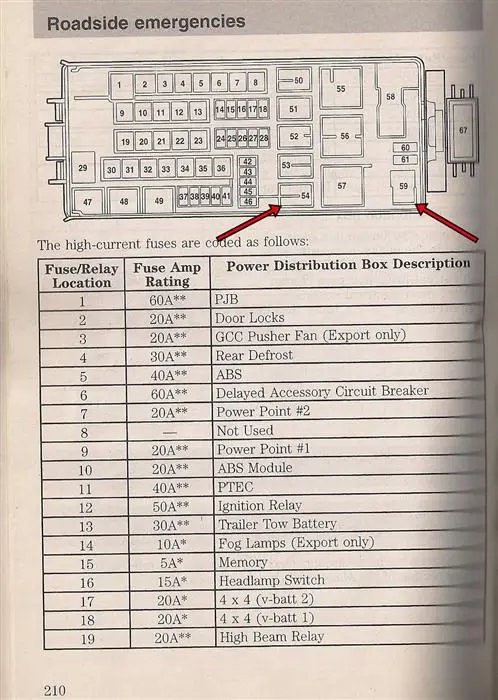

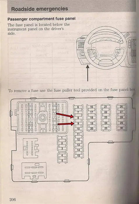

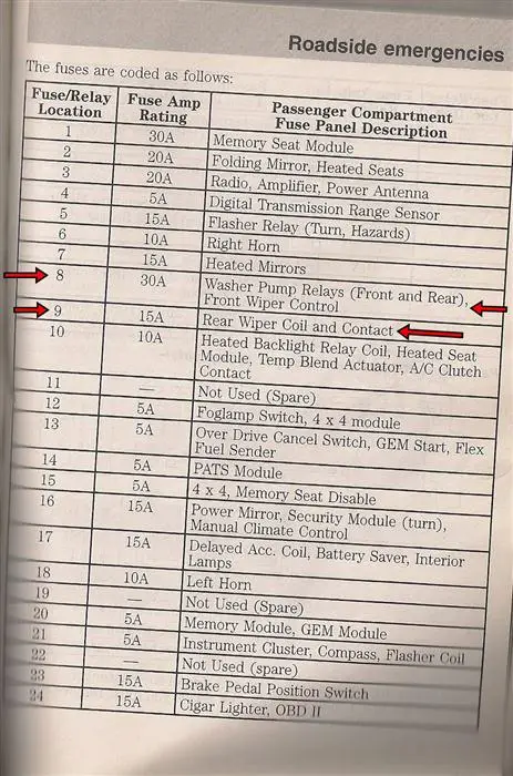

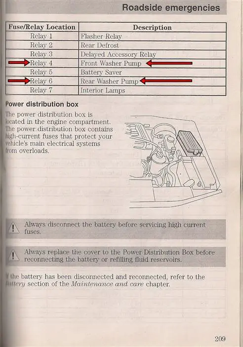

There are 2 fuses related to the wipers/washers in the fuse panel located in the passenger compartment. #8 is a 30A Fuse for the front & rear washer relays and the front wiper control. #9 is a 15A Fuse for the rear wiper coil and contact:

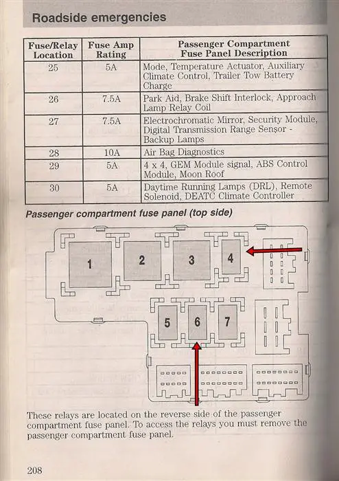

There are 2 relays related to the washers located on the reverse side of the fuse panel. #4 is the relay for the front washer pump. #6 is the relay for the rear washer pump:

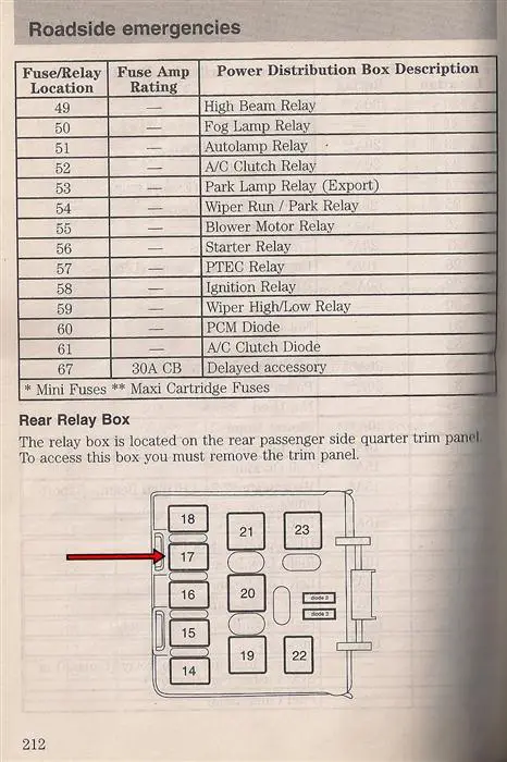

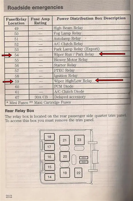

There are 2 relays related to the wipers located in the power distribution box located under the hood. #54 is the wiper run/park relay. #59 is the wiper high/low relay:

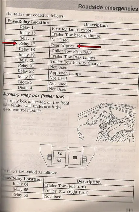

There is a relay related to the wipers in the rear relay box located on the rear quarter side passenger trim panel. To access this box you must remove the trim panel. #17 is the rear wipers relay:
