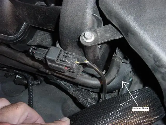

KCV190 PCV elbow, cracked, BOTTOM side. :rolleyes:

ncranchero offered good advice about checking the PCV valve connections. They are difficult to access with the upper intake manifold in place. My hoses were worn after years of rubbing against the firewall. I replaced the hoses and eventually installed hose clamps to prevent any leaks. SOHC PCV Valve Mod thru 2000
Check this out...
