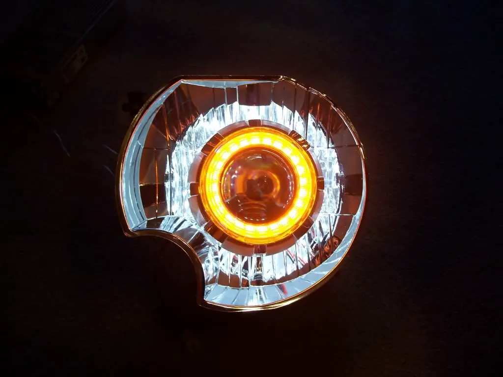

Almost done with this project, so I figured I'd post a few pics... I'm using a Morimoto Mini D2S, Gatling Gun shrouds and a couple of LED halo rings. The next part is to replace the side markers with LED arrays and add another LED array for to the side marker for turn signal.
Everything off:

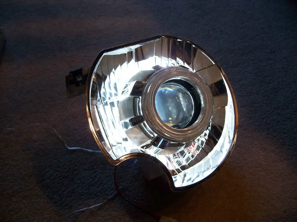

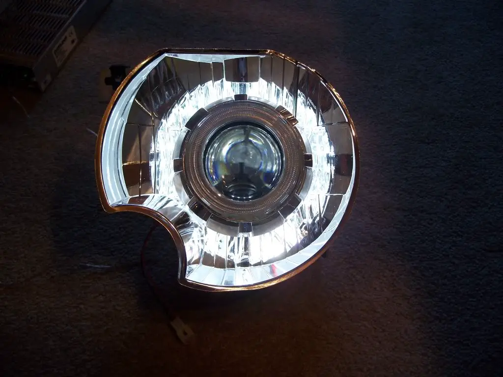

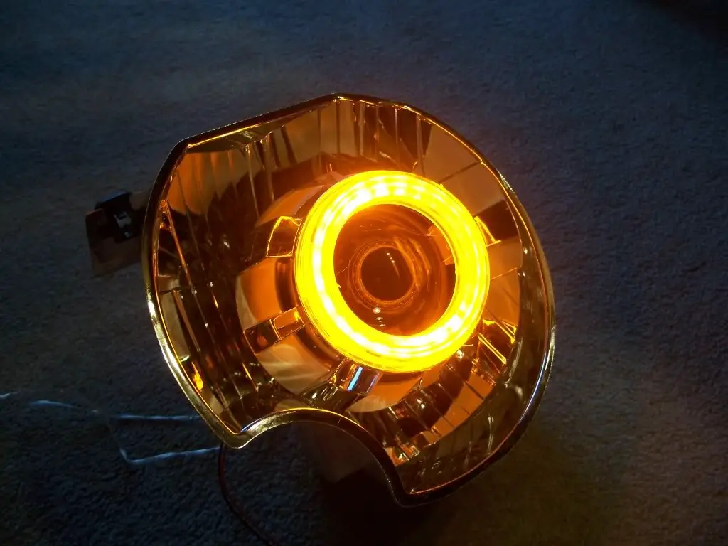

White LED ring as parking lights. The ring is mounted facing backwards, to refelect into the reflector bowl:
Orange LED as additional turn signal:
Both sets of LEDs on:

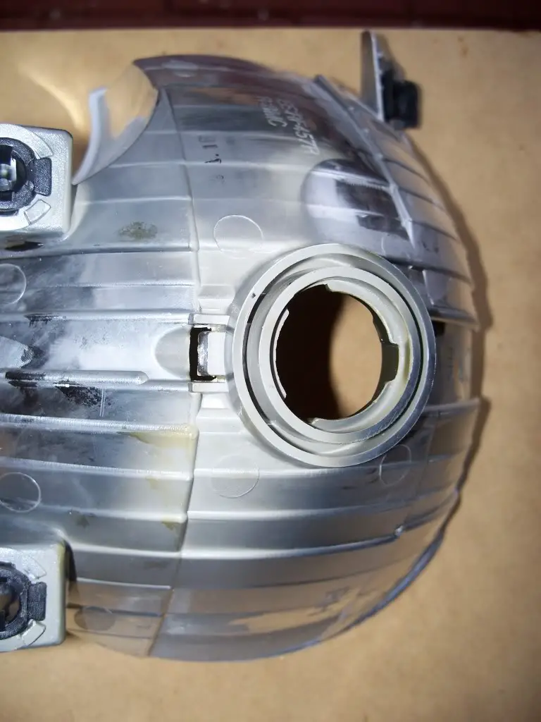

so with the morimoto mini's, you are able to use the stock headlight housing adjustment for the HID pattern adjustment? do you have to cut the 9007 bulb mounting point out?

I'll know this weekend whether the stock adjuster is enough, but I don't anticipate any issue there. My plan is to mount the entire assembly on the X, without completely sealing it, so that I can do the rough adjustments. Then remove everything, clean everything, seal it up, and hopefully I'll be set. I'm still a couple of weeks from finalizing everything: I'm waiting for some PWM modules for the parking/turn sidemarkers upgrade.

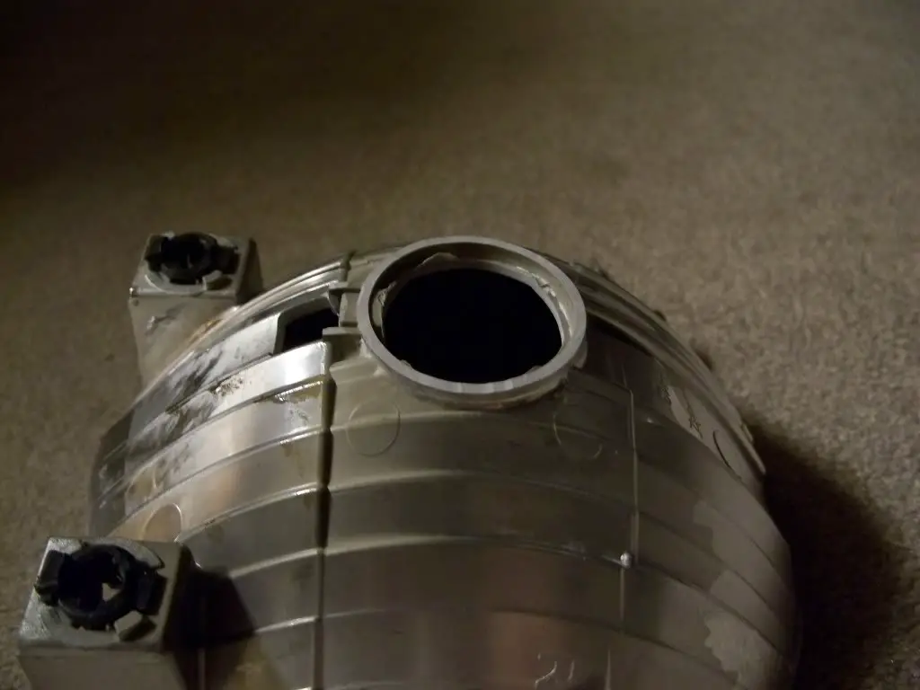

I had to trim the opening quite a bit to get the projector to fit. You have to trim both the opening and the back of the projector.
Before:
After:
Basically, I trimmed the hole all the way to the outer edge of the inner "ring". Keep cutting a little bit at a time and test-fit the projector: the smaller and the more centered you trim the hole, the better your default alignment will be.
I also cut the outer ring to where it is about flush with the edge of whatever you call that shield that was in front of the original bulb. That ring sticks out way too far to be able to screw the 2nd nut (the one that holds the HID bulb in place).

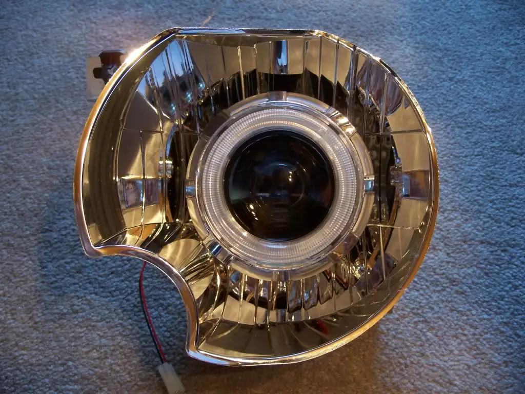

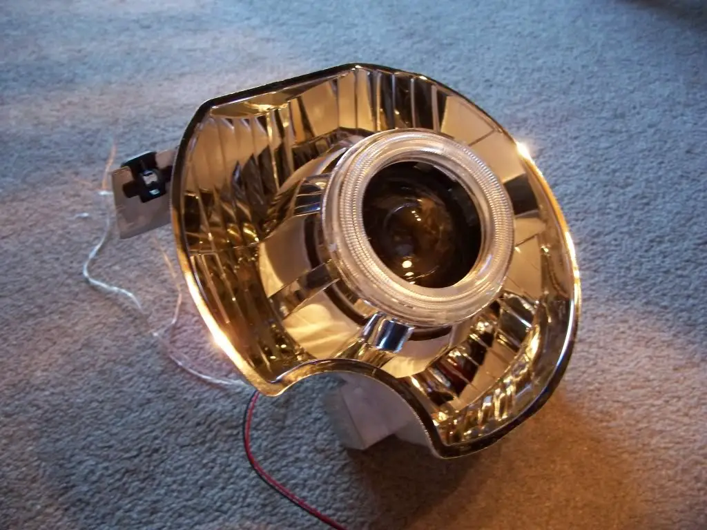

Projector Test-fit:

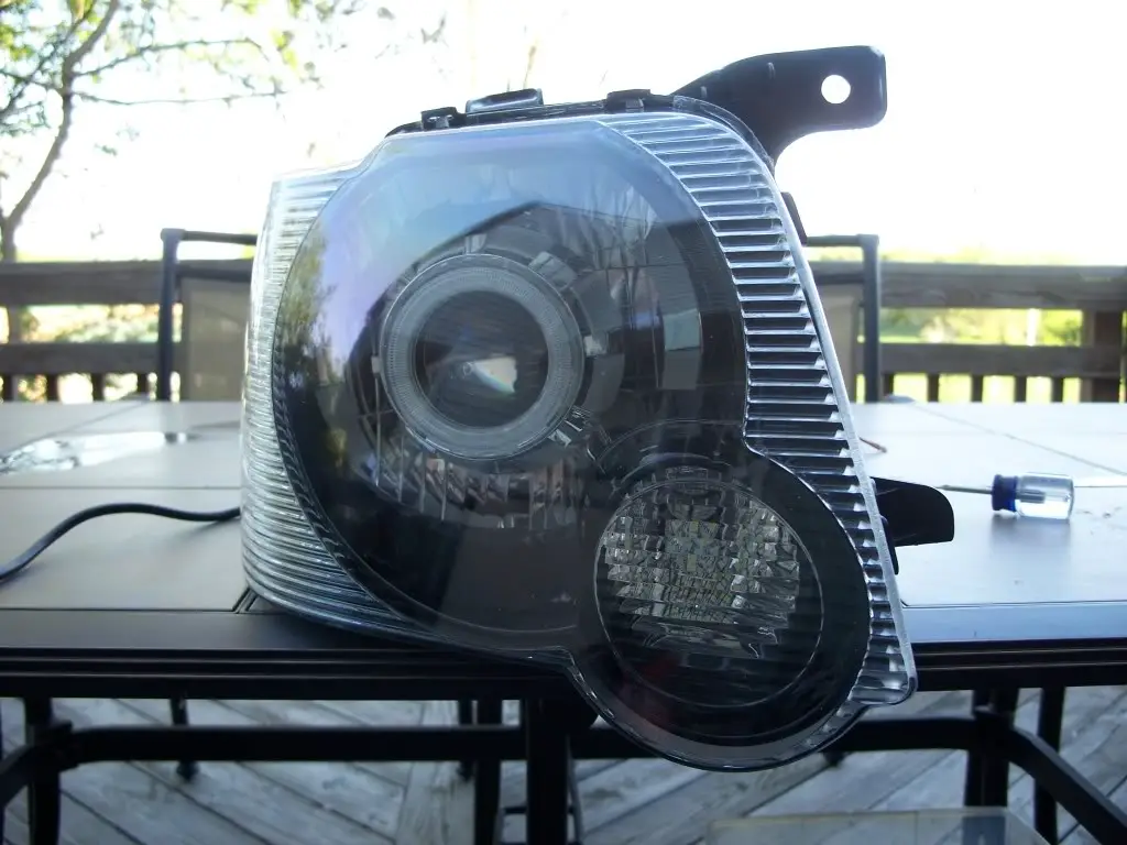

Some daylight pics...
Everything off:
Parking lights, with and without the HID on:
Parking lights and turn signals, with and without the HID on:
Side view, parking and turn signal, with the sidemarkers fired up. The sidemarkers are 2 pieces, one will be parking light, the other will be turn signal, but they are way too bright for my taste:
