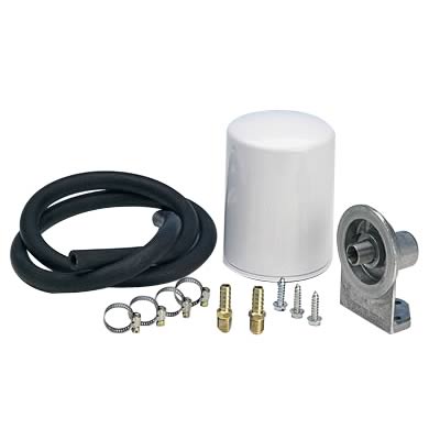

if you are going to install AP deep pan with dipstick I recommend to install Summit Racing Remote Transmission Filter Kit #G4980 with MotorCarft FL-400S Filter
Secondary Transmission Filter Installed (Feedback)
with that you do not need to drop the pan to do a trans flush
just keep change the remote trans oil filter every time you change the engine oil filter
this will keep the trans ATF fresh and very clean

I have a stock pan do you think i could still use the remote filter from summit? I just had my transmission flushed about 1000 miles ago so anything i can do to keep that fluid clean is worth it.
__________________
2008 Explorer 4x4 4.0L SOHC 53K miles
JaysOnTheEDGE is offline   Reply With Quote
Old 04-23-2012, 12:47 AM   #35
The Electrician
Makkah
2008 XLT 4WD V6
Join Date: Feb 2011
Posts: 517
Vehicle Specs
Mentioned: 0 Post(s)
Tagged: 0 Thread(s)
Quoted: 9 Post(s)
(Original Poster)
Quote:
yes you can and should use the remote filter and this setup can keep your ATF fresh and clean

When you run the auxiliary filter do you still run the one inside the pan?
