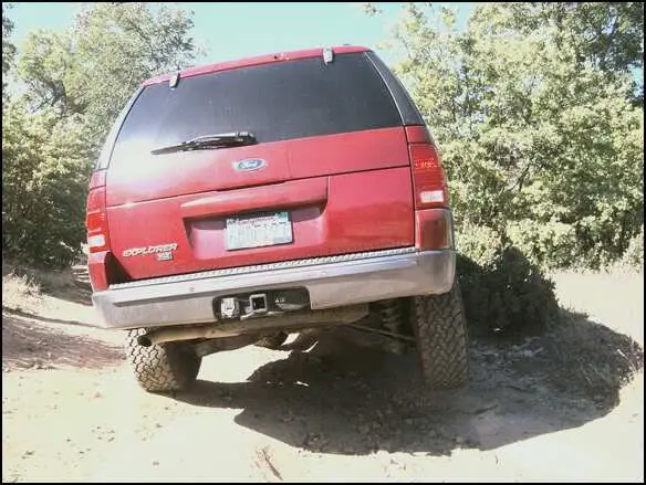

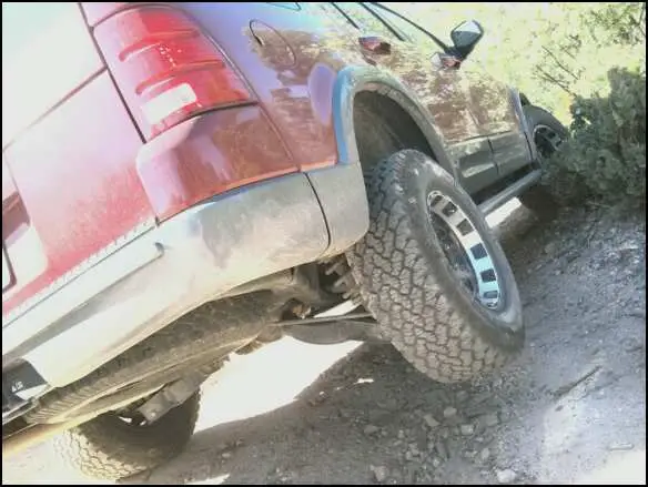

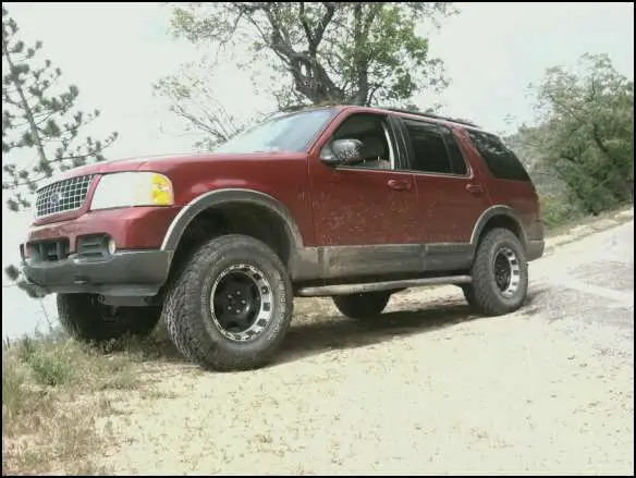

This is my 2003 XLT. I've run BTF spacers since November and LOVE them! Rollin on 265/75/16's. Just a couple pics from today. Recently removed the front sway bar, it makes a huge difference for me!
Future Mods: I plan to flush brake system/change rotors/change pads very soon here. That's about the only reasonable and affordable thing I can do right now!

nice ride, where are you at in these pics? that place looks familiar.

These are just little side trails off hwy 173 in Lake Arrowhead. Hope to hit the real trails later this week.

Three wheel drive!!!

Very NICE!!! Now disconnect that rear sway bar and see if there's any difference

looks like its the axle shafts hitting the frame loops (due to the rear spacer lift) that are limiting the flex in the rear, not the swaybar. Pretty much unavoidable with the way these trucks suspensions are designed.
A lunchbox locker or TrueTrac will help with the traction. Only way to get better flex is to do a rear SAS though.

Yea, removing the rear sway bar wouldn't do much, except cause a huge safety problem with the way I drive. CV's rub long before more flex is possible. By the looks of that area, they've been rubbing quite a bit.
Limited slip diff worked great as 4wd was not needed to back out.

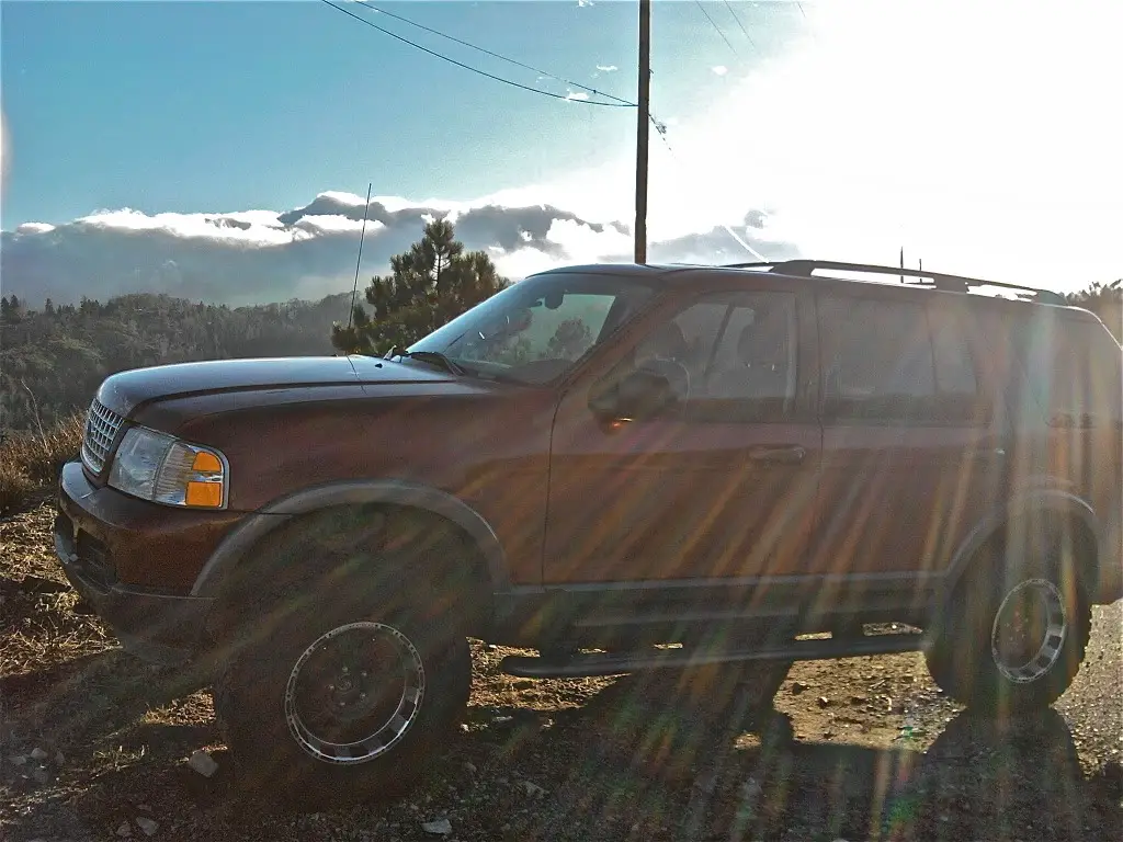

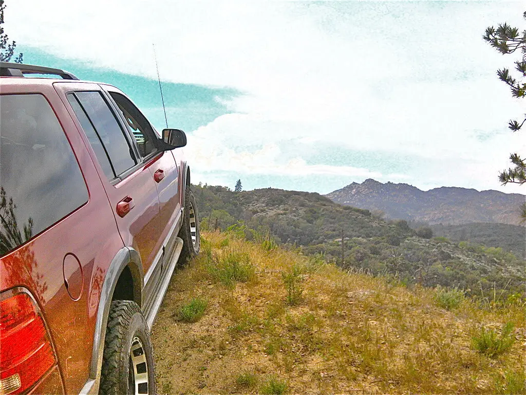

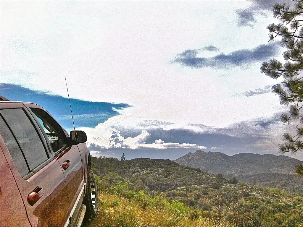

Just some cool shots of the awesome place I live!

that looks like it was photo shopped ... just looks like paradise !!!

I realize the suspension is kind of maxed out at drop with the lift, but the swaybar is limiting the compression of the other tire So with the rear sway bar disconneted, the rear tire won't drop much more, but it'll tuck the tire in a little better
If the half-shaft is infact hitting the frame, then just add some limiting straps. Add quick disconnects to the front and rear for when you hit the highway, then you'll be safe!

True, I didn't think about the compression part.
I'm looking into a limiting strap setup for the rear suspension on mine. I'll post something up when I can figure it out.

X2, wow man!!!

True, it would free up the rear end and feel softer. However, with majority of the weight being placed on the LR wheel already, it flexes just enough.
Disconnects would have to be custom made or modified. I just screw on/off the current tower that connects to the lower A arm. Limit straps are a must for front/rear in the future.
