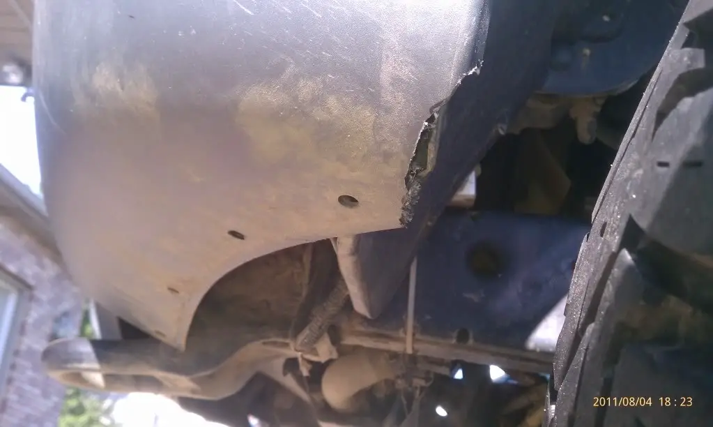

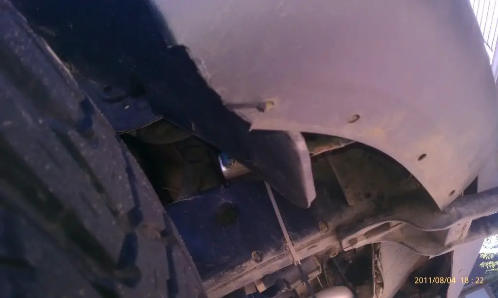

Inside bottom corners of the fenderwells (behind the foglight) and they rub the running boards and the outter bottom corner inside the fenderwell by the firewall. There some sort of metal plate underneath there that ill most likely have to cut out. There's no rub on level ground but as soon as the front suspension flexs while turning (backing out of my driveway) all of the previously mentioned spots rub like crazy. I'll take some pics when I'm done cutting today

I had to trim that piece behind the foglight too.
Nothing else rubs on mine though...doubt the backspacing difference between our wheels is the issue...probably has more to do with the width of those 285's.

heres my cuts. didnt end up having to take off as much as i thought once the running boards came off

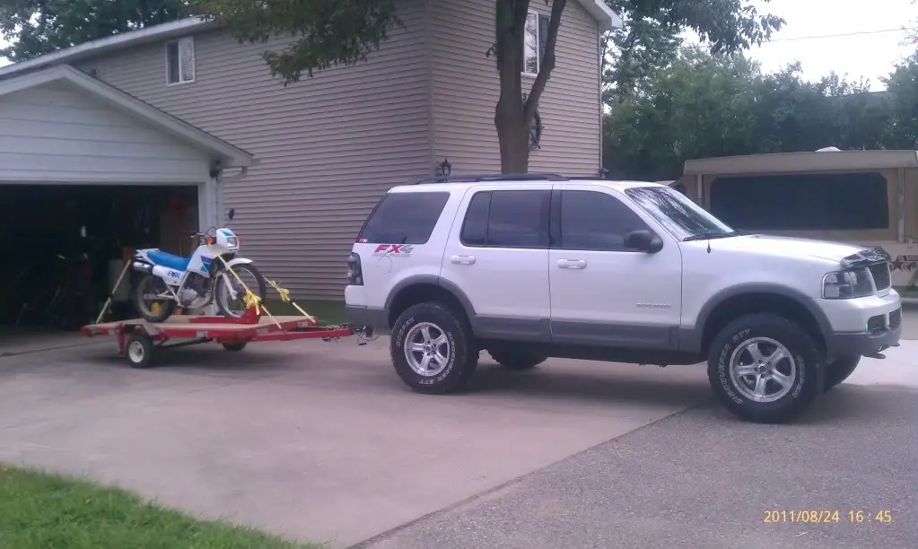

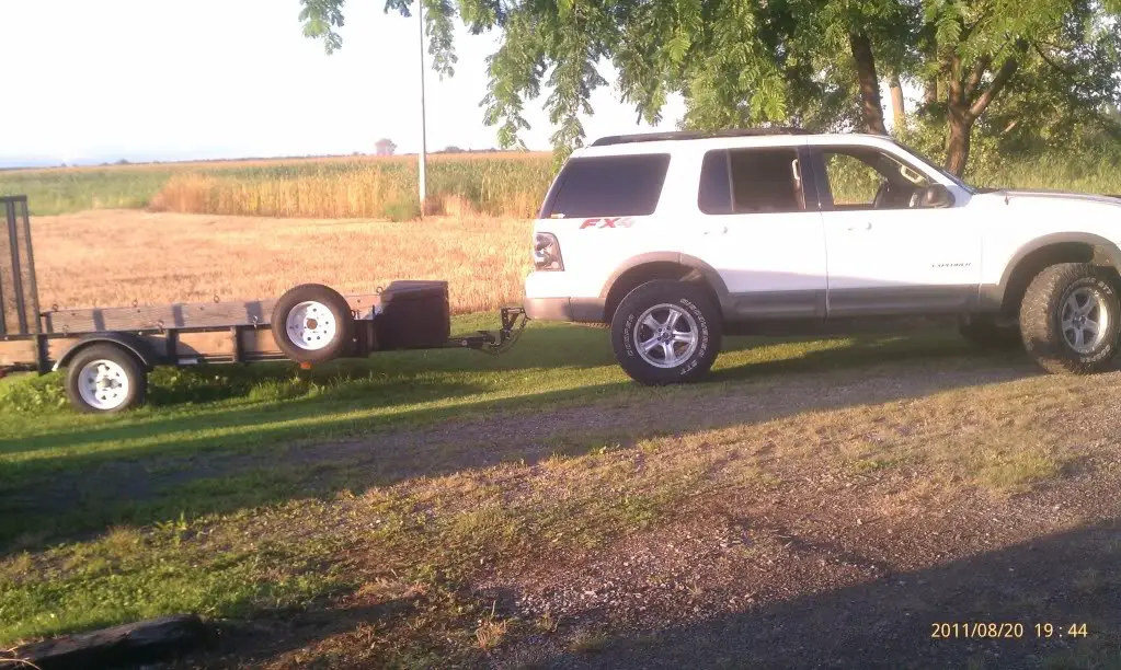

towing with 33"s and a 4.0 absolutely sucks! the gas mileage is horrible (around 11 mpg) and acceleration is horrible. WOT from a stop and the truck stays around 2k rpms and feels like the engine is bogged down

<cough*gears*cough>

lol i know i know. i really dont want to invest any more money into this pig lol
