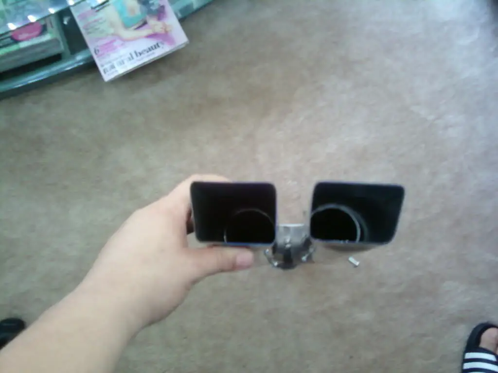

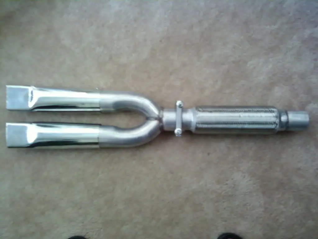

Hey I just finished a 3" body lift on my x and I have a gap inbetween the hitch and the bumper. Im going to cut out a section of the exhaust(remove resonator) and put dual tips out where the gap is.
And here is the exhaust section that is made up.
Let me know what you guys think.

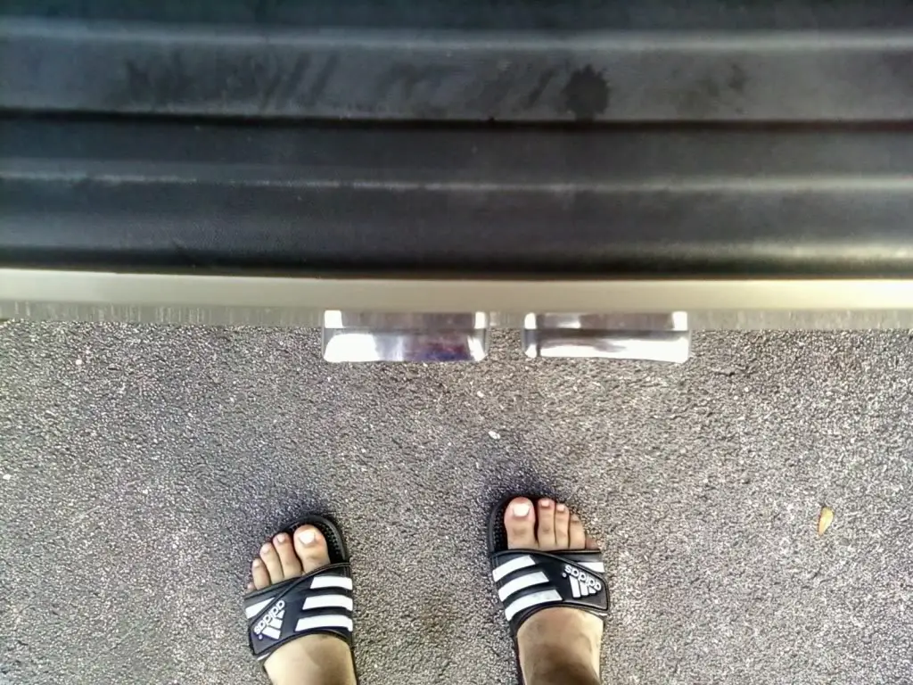

Its not the way I want it to look, its offcentered and because i used flex pipe it sways back and forth. Right now i have it "pinned" by using a bolt so it doesnt sway back and forth but it needs to be fixed right.
Anyone have any ideas? I want this to look good and right now it just looks like a giant poop. I think i could get away with it if it was centered but just knowing its not right is driving me crazy. Any ideas will be considered. Please help me out!!! Here are a couple pics to help you see what I see and everyone else on the road will see tomorow morning.
I think i plate from top to bottom to sandwhich it would work but I just dont know where to get one that large...

Got it fixed. Went to the home depot got a long piece of metal with pre drilled holes. Made a "u" bracket and bolted it up with the spare tire mounts. Really easy actually. Here are some pics.
