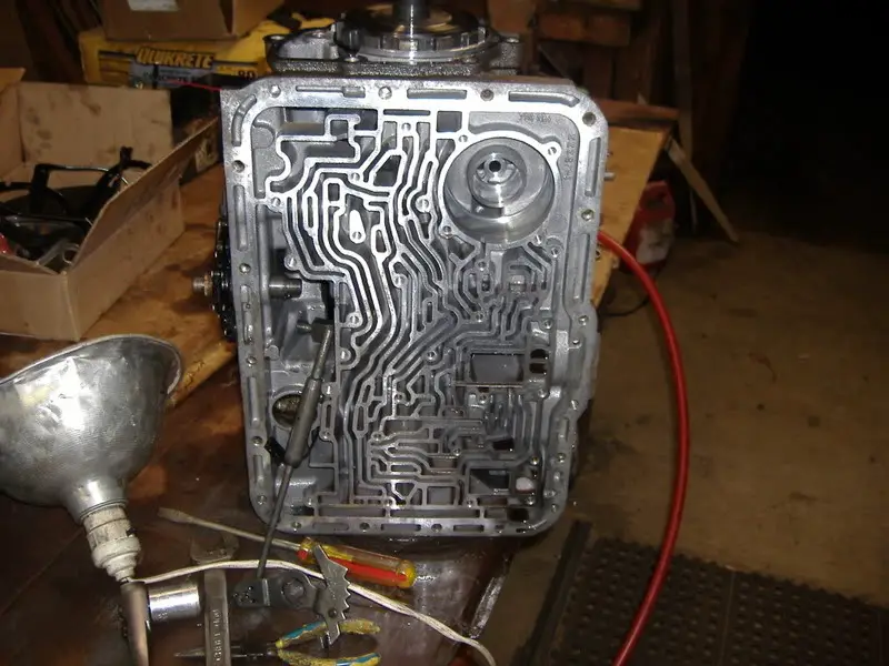

OK, bear with me, I am still kind of guessing...so your truck will start, I assume. Reason I am mentioning this is, as you know an auto trans will not start in reverse. Just for kicks, lets say the mechanic swapped the transmission, and changed the case extension, that is where the parking pawl can fall out, and if you don't know exactly how it goes back in...well, maybe there is a problem there, just a REMOTE possibility. For some reason, I am suspecting the parking linkage itself though, maybe that is all it is.
This is the best photo I have now (5R55E with the extension housing removed), probably not your trans, but maybe in the same family. At the top of photo, the wheel w/ cogs, that is what the pawl catches to lock you in PARK. To the left of the wheel, in the little recess, that is where the pawl lives. Further down, the rod and the thing with the saw-teeth (where the "clicks" come from), that is your internal linkage, which connects directly to the external linkage shown in your vids. All that stuff works together to PARK.
Sorry, Phantom, this is not much to go on. Hopefully someone more knowledgeable can expand on this.

Quote:
EDIT: I think Turdle just did.
ok well i have to put it in nutral to start it. otherwise park acts like reverse. and when i played with the external linkage like in the video it kind of clicks over half assed then clicks back. you said you suspect the parking linkage to be the problem so my question is how do i go about fixing that and is it worth fixing or should i go for the other transmission with another 90 day warranty i dont want to swap in a transmission with other problems that are potentially worse then my current. i think this truck has 5 gears im not 100% positive. do you know how i can identify my transmission
