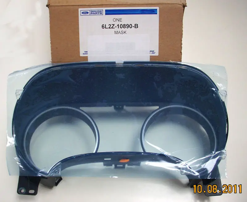

The Gauge Cluster Plexi glass on my 2007 has a crack in it . Is this piece available and what's the easiest way to perform the switch ?

Swap it out with a junk yard piece. I don't think this has ever been covered on this MB.

Thats what you will get if you buy a new one.

Thanks . Does that piece also include the clear plexiglass that covers the gauges ?

As far as I can remember the plexiglass that comes with the mask is the only plexiglass that covers the gauges.
And you should not try to change only the plexiglass. It has several plastic clips that brake very easy

Removing the instrument cluster is very easy.
Removing the mask from the gauges is a little bit tricky. On the picture above you can see the eight black "open" clips that hold them together.
More pictures here:
