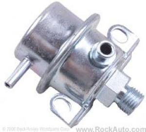

The 1998 has a fuel pressure regulator (FPR) mounted on the fuel rail and the 2000 has a fuel pressure damper mounted on the fuel rail. Both would have a vacuum connection. The FPR has a port to allow excess fuel to return to the tank. If your mechanic used the FPR then the return port would have to be plugged some way. Here's a photo of a typical FPR.
Thanks 2000, the thing on this rail looks more like a pancake. I'll take another look to see if it has a return line. Either way, do you know if the injectors are compatible?
