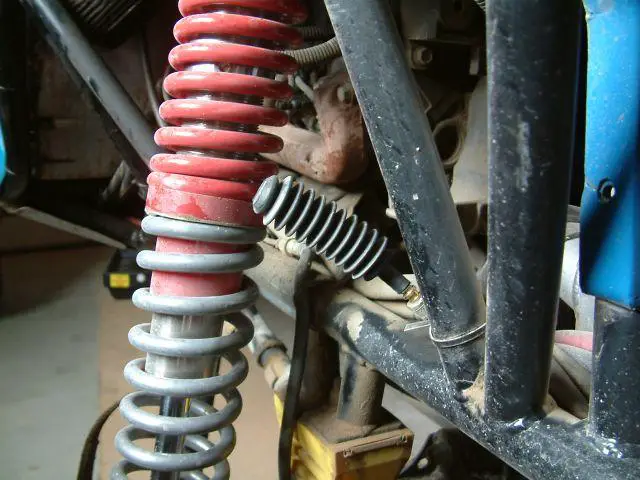

I run these...

IZwack, Ray and Stic-o - Thanks very much for the suggestions.
That little bellows is a clever idea.
