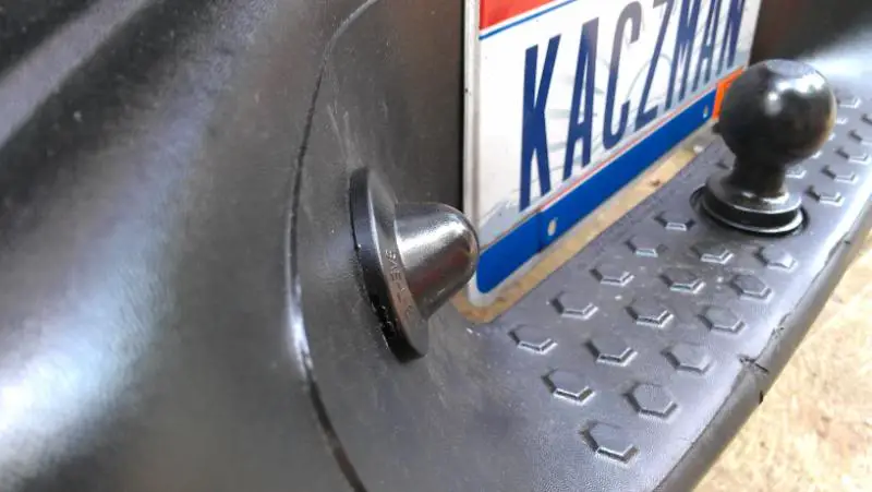

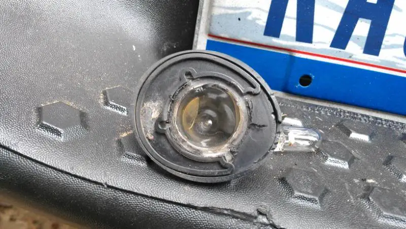

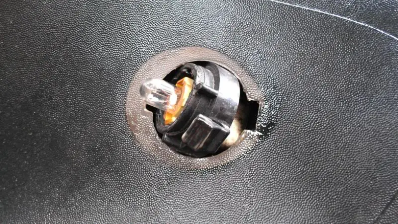

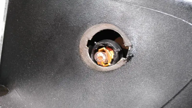

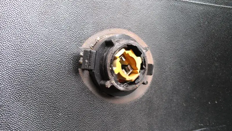

Hello all,
I took these plastic covers off to replace my license plate lights. Now I cannot get them to stay for the life of me. The bulb housing just keeps falling into the bumper, and the outer cover looks like it has no method to attach.
How the hell do I get the bulb housing to stay in the bumper, and then put this cover over it? Is superglue the only way?

You broke the housing ........... the socket just twists and comes out of back of the housing. You must now buy new lights.

sweet. how does the new housing get installed?

It will just push into the hole from the outside of the bumper. The square tabs on the part of the broken sockets in your photos retain the new housing into the bumper.

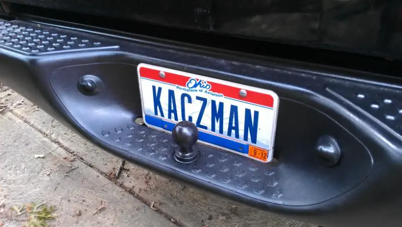

Hey guys thanks for the help. Using the diagrams you posted, I just broke the housing more, modified it to fit a set of 154 6K leds, then use clamps and gorilla glue to reattach the assembly. Let sit for 2 hours, and they snapped right back in perfectly. It looks awesome, Ill have pictures tonight.

I couldn't get my big hands behind the bumper to remove the light bulb from that side so I tried the other, snapped the housing off and glued it back together. That only lasted until the next time I tried to remove it, same thing happened so I got a pair from a junkyard Explorer.

looks awesome. its the little things that matter.

Lights are looking good, those are the LEDs?
Also, nice license plate, and quick question, where did that name come from??

Yes, they are 5K LEDs. 6K is too blue for a license plate light.
Kacz = last name. Kaczman = nickname.
