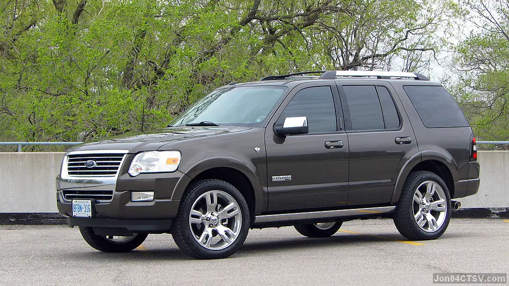

Quote:
Originally Posted by EX.07 View Post
the other one
That's my truck. Well, was my truck til I sold it a few weeks ago. Loved those wheels. They're the reason the Explorer caught my attention in the first place.
Had many compliments about them. Some guy even wondered if they'd fit on his Magnum.

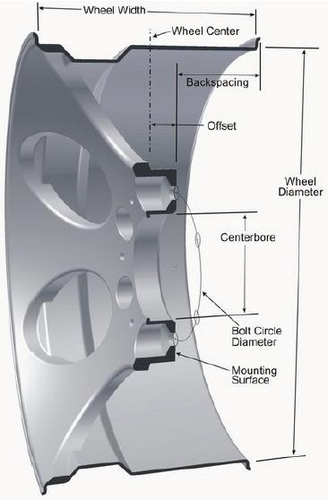

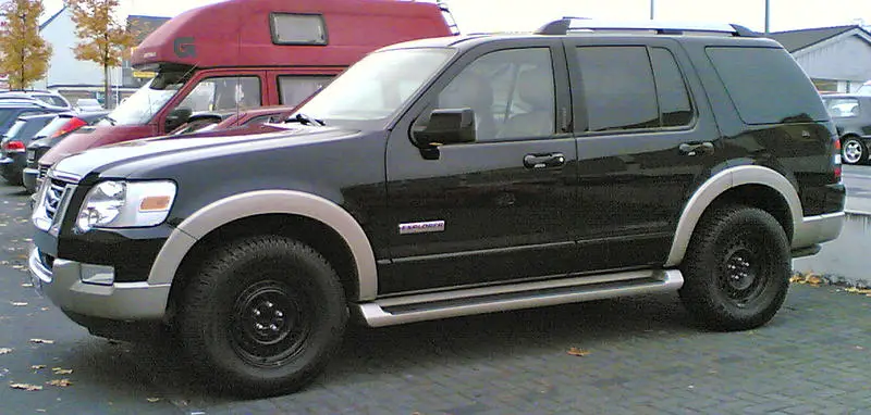

114.3 (4.5 inch) is not the offset, it's the bolt circle diameter!
The rim offset (ET) of a 2006 Explorer is 44 mm. Compared to the new offset of 39 mm it's nearly the same. The wheels will come out a few milimeters. No need for spacers.
Picture shows 17" wheel of 2007 Explorer:
I use the 16" rims of a 2nd generation Explorer.
Compared to the original 17" rims which came with my 2007 Eddie Bauer (17 x 7.5 x 44) they have an offset of 12 mm.
They come out nearly 30 mm more than normal at each side.
The lower the offset (ET) is, the more the wheel comes out.
Picture shows 2007 Explorer with 2nd generation Explorer 16" steel spare rims (ET = 12 mm). 255/70/16

No, because the center bore diameter of a Taurus is 63.9mm.
That's the hole in the middle of the rim.
The Explorer's center bore diameter is 70.5mm.
The bolt pattern, also known as the lug pattern or bolt circle, makes up the diameter of an imaginary circle passing through the wheel lugs' centers.
Bolt patterns found in Ford automobiles can be made of four, five, six, or eight bolt holes.
A 5-x-115-mm bolt pattern, for example, would indicate five bolt holes, each 115 mm apart.
