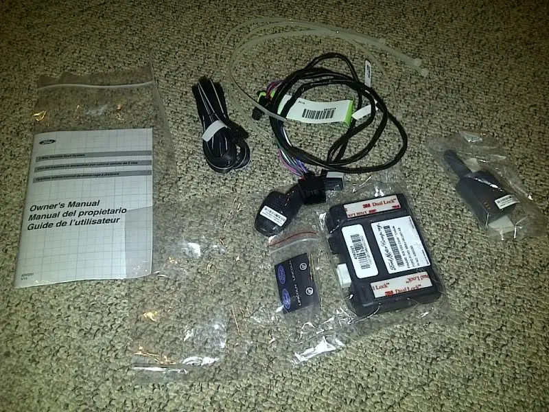

So I finally got my new command start and decided to put it in this afternoon. I purchased the starter from partscheap.com. It is the bi-directional unit without the integrated alarm.
The kit includes the following parts
Antenna
Antenna wiring
Control Module
Module harness
Remote fob
Zip ties
The only tool you will need is a 9/32" socket and wire cutters to cut the zip ties. I recommend buying extra zip ties as the kit only comes with 4. I used 20 + but I like to keep things clean.

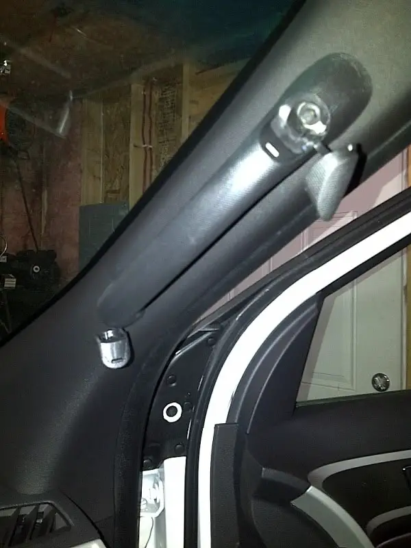

Step 1: Remove A-Pillar trim on passenger side.
Remove two 9/32" bolts holding the handle to the pillar.
Pull firmly on plastic molding and clips will release at the top.
The bottom is held in place with plastic feet that slide into the holes shown below.

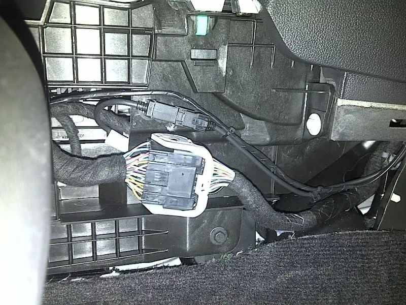

Unplug the TPMS sensor plug which is located at the bottom.
Plug in the new harness male plug into the TPMS port and connect the old plug to the female connection.
