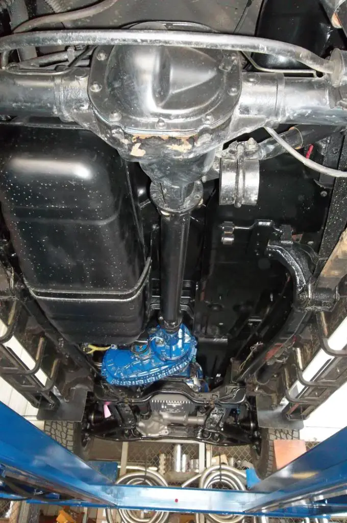

Well I ordered all the intake parts I think I need to make it work! Once I get them, I'll take pictures of them and post up the part numbers for anyone else who wants to do this.
Here are some pictures I got around to up loading
During lunch I ran to the exhaust shop and put my thottle body on which I modified the pull on. It is a 75mm BBK TB for a 86-95 mustang so I had to change the pull so I could use the Explorer throttle cables.

Here are a few pictures from today. The exhaust isn't even started yet but at least I got some good pictures of the underside with it on the lift! They "said" they would start on it next week.. I hope

Very nice, I appreciate the effort put into cleaning and sealing that underside. I hope I can make some progress with mine soon too.
