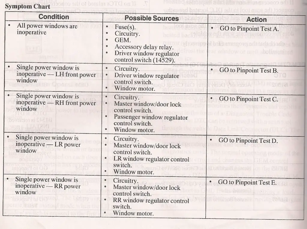

Now that I think about it, it sounds more like the window motor is at fault.
Here is a great link for troubleshooting the power windows, thanks to theofam for this great link http://www.scribd.com/doc/14896086/2...stem-Diagnosis.
I used this link to troubleshoot my window issues and it was a lifesaver! I have it downloaded and can email it to you if you want.
Since you say that the front passenger window is not working then you need to go to Pinpoint Test C:
