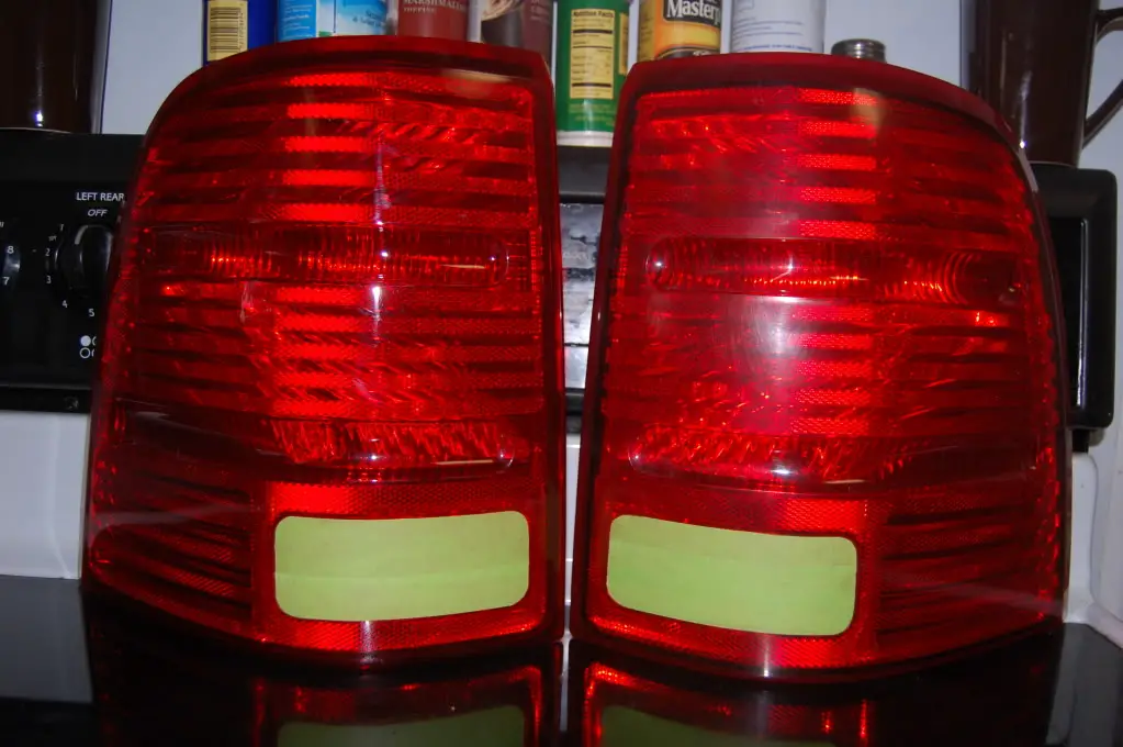

3. After you clean off the lights, take your painters tape and tape off the reverse light. The best way I found out how to do it is two separate pieces. Do one half and then do the other. It seems to make it a little easier to see where the clear meets the red. If you have a light, you can shine it into the reverse hole and it will help a ton. You can either trace off where the clear meets the red or you can go straight to the razor and trim off the excess tape around the reverse lense. Of course, do this for both.

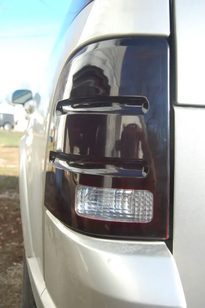

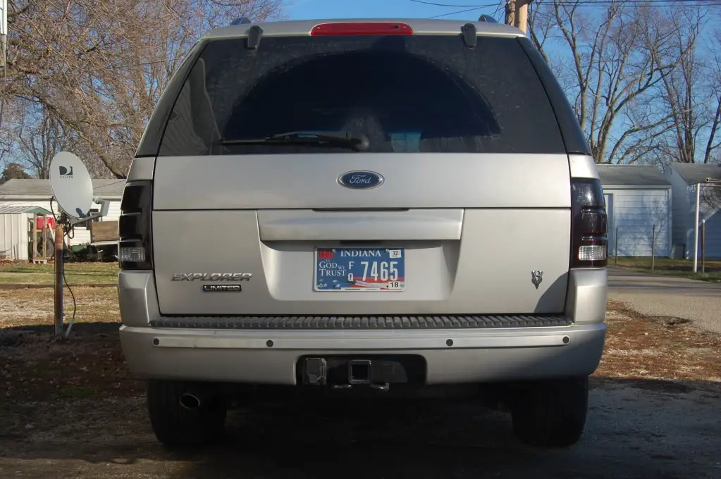

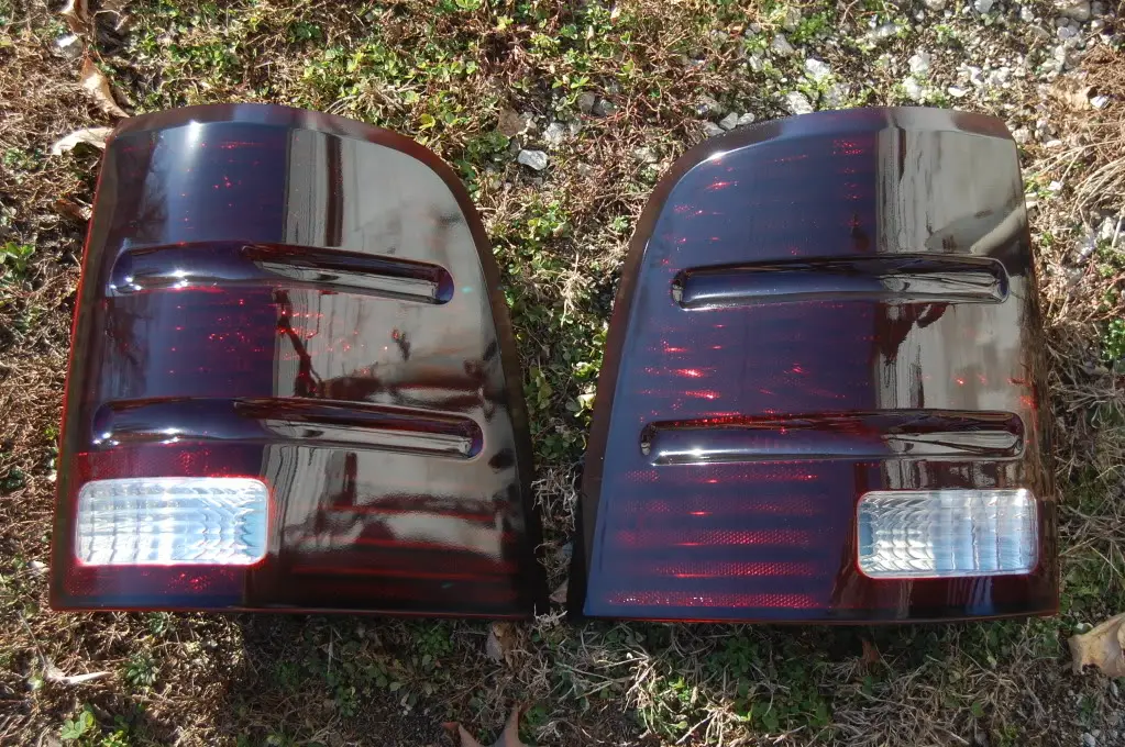

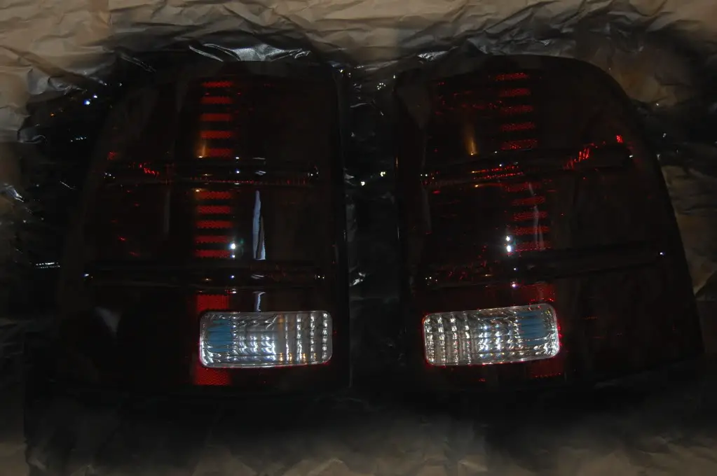

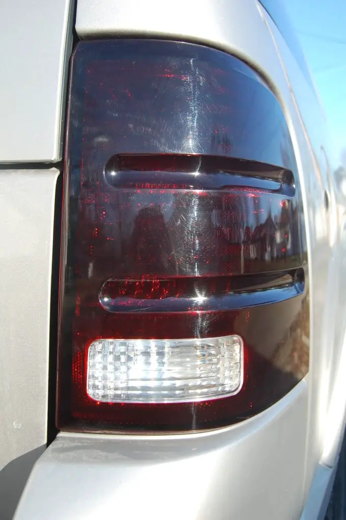

Here is my finished product:

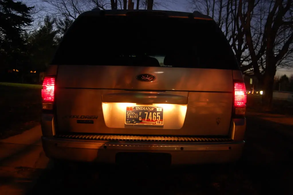

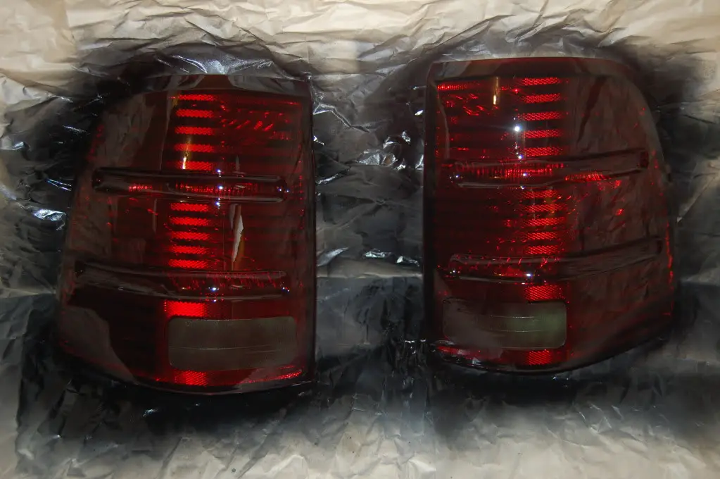

Here is parking lights:

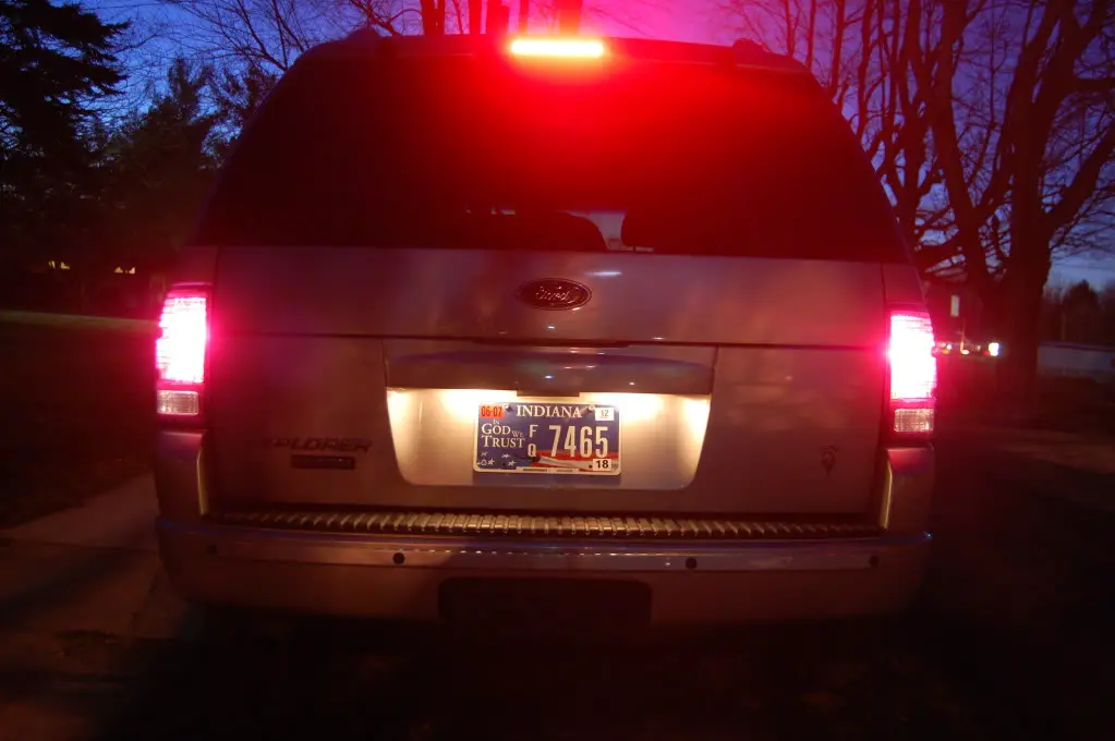

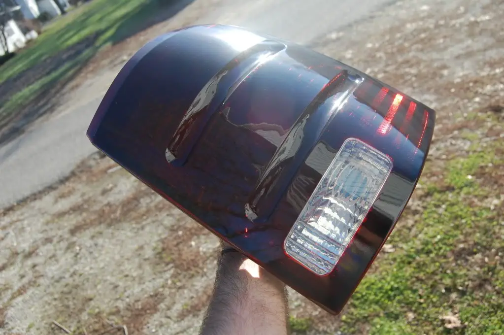

And brake lights:
Naturally I forgot to pull the third brake light in this entire process so I still have to do it, but it will be done soon.
