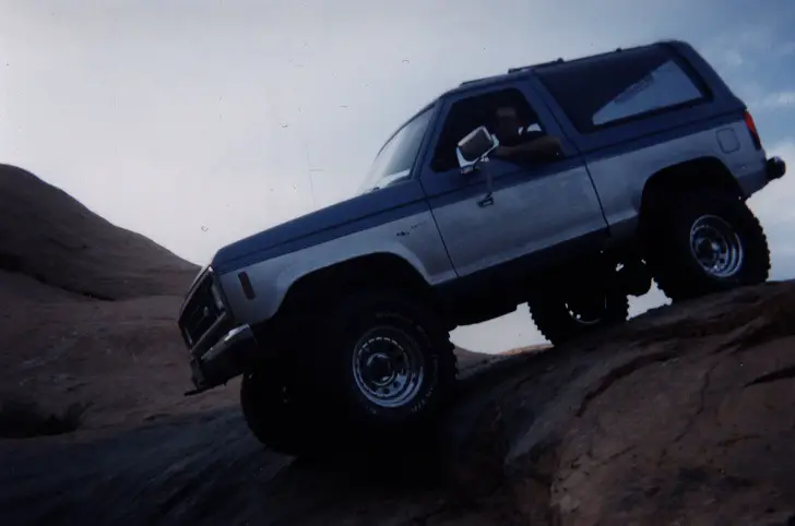

30's fit stock with a little rubber mallet work to the rear edge of the front fenders. 2" coils and blocks clears with lots of room and flex. Like Backwoods said they will live with bigger tires and sense. Here's my 88 with 33's in Moab. Didn't Start breaking things till i went to the long radius arms and then over-flexed the center joint.
