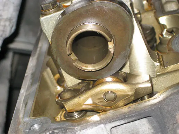

It's too bad you didn't keep the compression results. Low compression on all cylinders on one bank usually means that bank's timing chain has slipped. Low compression on all cylinders may mean the primary (crankshaft to jackshaft) chain has slipped which is not common. Since you have the valve covers off it is easy to check the camshaft timing. When cylinder #1 is at TDC on the compression stroke both camshafts should have the timing slot below the axis of the camshaft and parallel to the head surface that mates with the valve cover.
