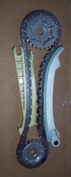

This is my new one almost identical to the old. Since the old one is not broken, there is now way in hell the width from the left of the pivot to the edge of the metal on the right is coming out the top. WTF?
The 2002 and later SOHC V6 has the metal reinforced cassette guide on the slack side. To my knowledge there were no improvements to the timing chain related components after 2002. Obviously, to replace the rear chain the jackshaft rear sprocket must be removed. Since you have the engine out I suggest that you replace the entire cassette (sprockets, chain and guide). The jackshaft rear sprocket retaining bolt loosens counterclockwise while the right camshaft sprocket retaining bolt loosens clockwise. I had trouble inserting the rear cassette but no trouble removing it since it was broken in pieces. See post # 252 of: SOHC V6 Timing Chain Saga The guide must come out the top thru the opening in the head. See SOHC V6 Rear Cassette Replacement
I haven't gotten to the rear guide yet because I was having trouble getting the jackshaft bolt loosened. The front one doesn't appear that it will ever come out from the top due to the width of the pivot bearing and the all metal construction (plastic attached on the inside)

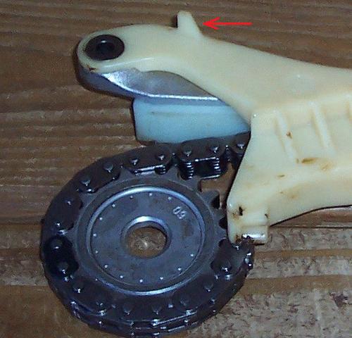

yep, first thing. What I'm calling the "pivot" literally is too wide to pass through the head. It moved up and down as long as it is in the block but once pulled up it won't budge past the lip of the head. Put vice grips on and pulled hard but it is so wide that it can't even pass the lip of the head.

The tab is what gave me a problem.

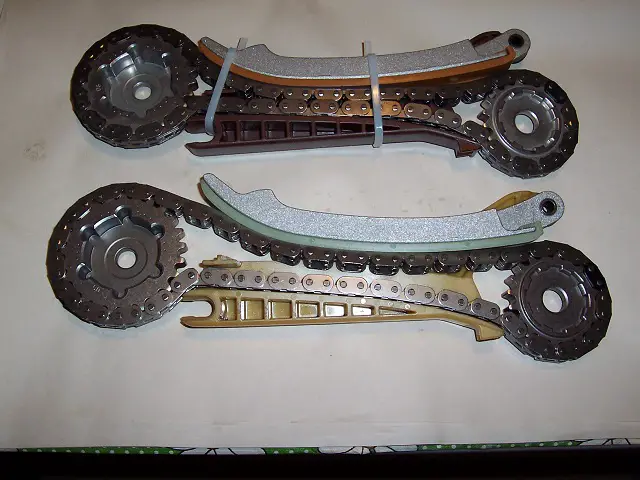

I couldn't tell much from your photo. Here's two examples of rear cassettes (Ford OEM and Borg Warner):

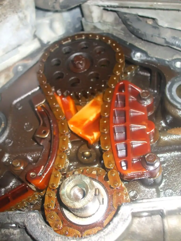

I'm working on the front upper guide from the jackshaft to the right (driver) camshaft
from the front of the head:
new one showing width
And that has to come out from the top right of my last picture, once you undo the jack shaft sproket
The chain and sprocket holding the upper front camshaft are off (in picture below i put main sprocket back on to try to get jackshaft off from the rear). The guide is loose but it will not pass the head.
