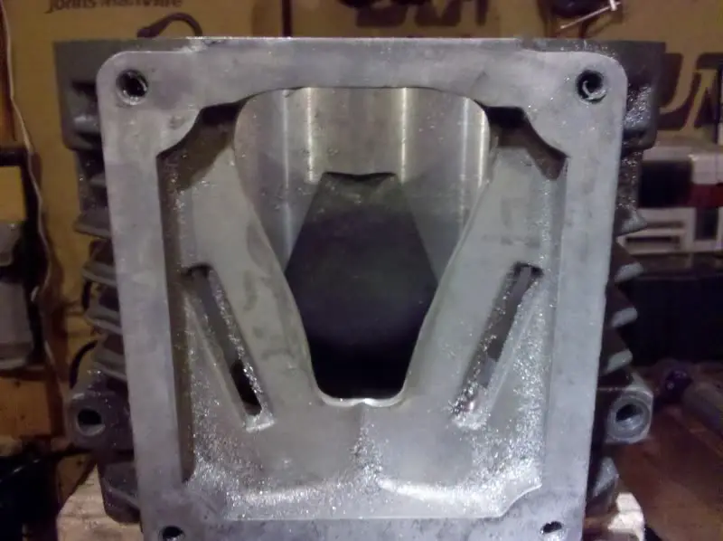

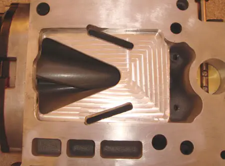

Just went back and saw this post
Quote:
Originally Posted by jd4242 View Post
maybe its just the pic or im use to 3800 m90dont get me wrong not saying you over did it or anything like, that just saying it looks big compared to my 3800
YOURS
MINE
So looks like this was irrelevant to your chargers so that IC core from ZZ may be too larger for you all.
An intercooler will be very difficult for me to adapt to my current lower intake setup. Im going to try with no intercooler and see how I make out.
I'm hoping that with a bit of porting, and using a egr system, I can keep temps low enough for low to moderate boost levels to be ok. Hopefully James can tune around the higher temps.
Not to change the subject but on a side note about porting.you remember you said you dont know why they removed that bar on the bottom of my unit when they port it it?well found out why,they remove it for use on intercoolers,they said it allows more air flow through more suface of the cooler.they also suggest you open the inlet on your lower intake manifold to match the rectangle of the IC instead of the little square thats the size of the sc outlet.they said it made a significant decrease in temperature .i googled it and seem alot of people are split about removing it but half wasnt running a IC or half didnt enlarge there lower manifold.so im having it removed and going back and matching my LIM to my IC
That makes allot of sense since they are doing an aftermarket AWIC system with the blower.
There are ways to work around using a larger than needed core. Now if it were too small then that may pose an issue but a quick call to ZZP will yield those dimensions. If it is not wide enough then that Bell Intercoolers core will work for sure once some end tanks are welded or brazed on.

Quote:
I can give you a ruff measurements if you cant get ahold of them.there pretty good on customer service tho

I took the M90 apart tonight, and found the reason for the oil leak....No sealant was used when the snout went together. There wasn't much oil in there (Maybe 3-4 ounces).
Also, the oil had no smell. Its not the same smelly stuff I hear people talk about. Maybe the bearings are still good...Maybe not. Theres a few strikes against them based on what I found.
I still think its best practice to rebuild though. No telling what other surprises there are. I might pack up the rebuild kit (Minus the oil), snout, and bearings for shipment to Rocket. I think cost of shipping will be lower with the blades removed, and packed in a smaller box.
