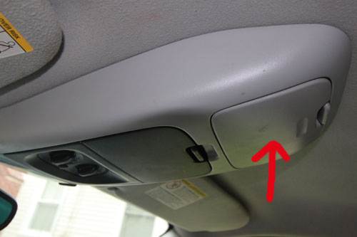

Located in the remote holder is a Philips head screw which is the only thing to remove, to remove the console.
After removing the screw, slowly pull down working from the back. There will be 4 wire harnesses to unclip.
