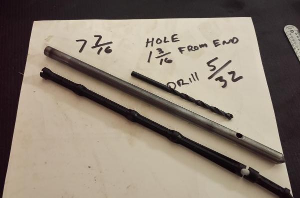

there is a plastic pushrod that tee's into the metal pin that you noticed keeps slipping out. the problem is most likely that the plastic pushrod is broken. Can you squeeze in the shifter button when the truck is in park? If so, the plastic pushrod is broken.
to remove the shifter, slide down the chrome trim at the bottom, and loosen the set screw. lift up the shifter handle, and you should be able to pull out the broken plastic pushrod. if it's broken, there will be another piece, and a spring under the horizontal pin that keeps slipping out. To remove the broken piece, pull out the horizontal pin.
The black piece with white grease is the pushrod, only relevant picture I have..
I used a piece of steel rod about the same diameter as the plastic pushrod, cut it to the same length as the plastic pushrod, and drilled a hole in the same place as the hole the horizontal pin. secured the horizontal pin into the new steel pushrod with a little epoxy at the time of reassembly.
It took a couple of hours to tear into the console, get access to it, and fab up the steel replacement rod, but it's a permanent fix, one less thing to break. and from the number of threads i have seen on this, maybe someone with a little more free time than myself should make a batch of these steel replacement rods and sell a 'repair kit'...
