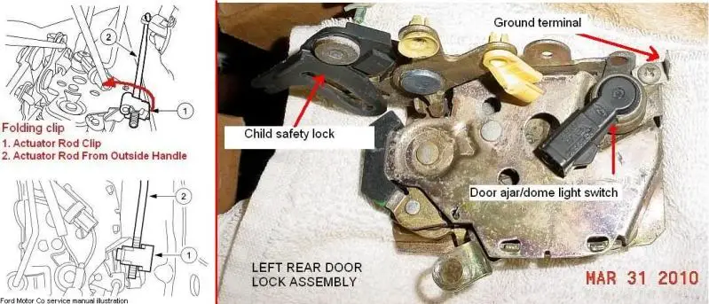

I'll may agree with the door switch but most people have the opposite problem with it. It IS on the latch itself.
Do the dome lamps work properly when you open and close the drivers door?

@ ncranchero. Good question, something I failed to mention and another reason I think it could be the door ajar switch.
When the driver door is open the dome lights do not come on, also the open door light in the dash does not come on. If any other door is open the dome lights come on and the dash light comes on.

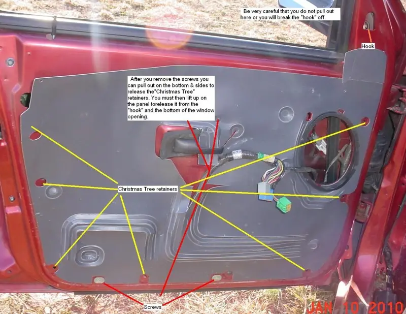

Use care when removing the door panel or you'll break off the top mounting hook.

Confirmed, the door ajar switch is broken. It's snapped off and hanging by the wire.
Dealership wants $64.50 for a new one plus labor to install. I could do the install myself but I'm heading out of town for a job. I may just wait and get the part and fix it myself at this point it's just an inconvenience.
And thanks ncranchero for the picture of the latch assembly, it helped a ton.
