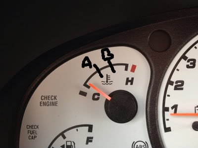

I looked down, and saw the gauge steadily moving up, about 2 degrees every couple seconds, it got up to like 228-232 before I quickly shut it off. I turned the key on about 5 minutes later and turned the air off, it was down to about 220. I checked the engine bay, under the Explorer, and didnt see any signs of leakage, or blown lines etc.

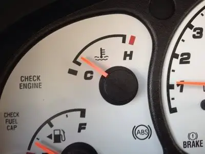

We started driving, AC off and it got back down to normal temp pretty quickly, (~190), so I turned the AC on and a few miles later noticed the temperature was still dropping.
Now while driving with the AC on, it stays at like 158-160.
AC on:
And with the AC off, it drops a bit more.
Im letting it cool down right now before I open the radiator cap, but im guessing maybe my thermostat is stuck open? It NEVER used to fluctuate, AC on or off, it would always stay right below the middle.
Im really hoping no damage was done letting it get that hot, (I turned the motor off within seconds of noticing that it was climbing, plus I was sitting still so there was no load).
A: Where it normally is no matter what. AC on, heat on, off, running for 2 hours, always sits right here, only fluctuates a matter of a couple degrees.
B: How high it got up to today right as I shut it off.
Any idears?
