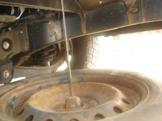

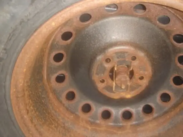

And here's one of the rusted out spare:
I thought it was going to dissolve into dust if I touched it, so I didn't bother even taking it off. I think the tire may still be usable, though? Looks like the original spare, it's a Michelin.

Highly recommend you inspect the tire winch and cable.
Too many horror stories of them failing at highway speeds.

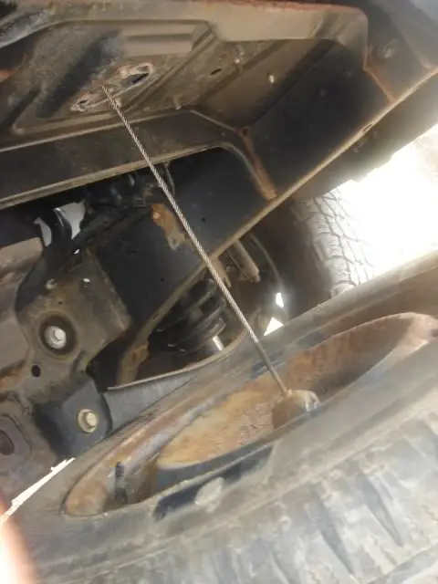

Just lower the spare and check for cable fraying or binding.
IIRC, the winch cable may be stainless. Can't ever be too safe.

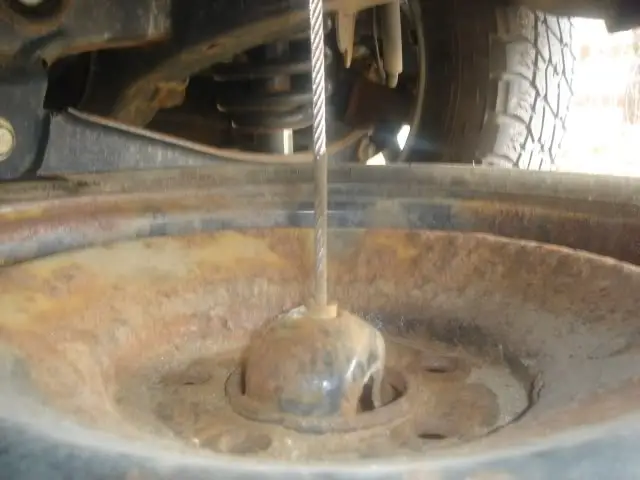

What do you think?

I just took the spare off for now. I wouldn't have used it anyway. I don't think I would trust that wheel on a Geo metro, let alone a 4x4.

It's just surface rust, I wouldn't worry about it. If you do want to worry about it, wash it, wire brush it, and hit it with some POR-15 paint. Wear gloves. If you get the stuff on your skin it takes about two weeks to wear off. I know this.
If the idea is to have a matching 5th tire and wheel to rotate in, I would try the hoist on one of your regular wheels first. I could be wrong, but the center hole on the aluminum wheels looks smaller to me than the one on the steel spare and the hoist-wheel-holder-thing might not fit.

I doubt that tire is still good. Tires have a timeframe of usefulness and 6 years is pushing it, IMO. I think the wheel is most likely still useful following Johnny's suggestions but I'd be afraid of using that tire.
