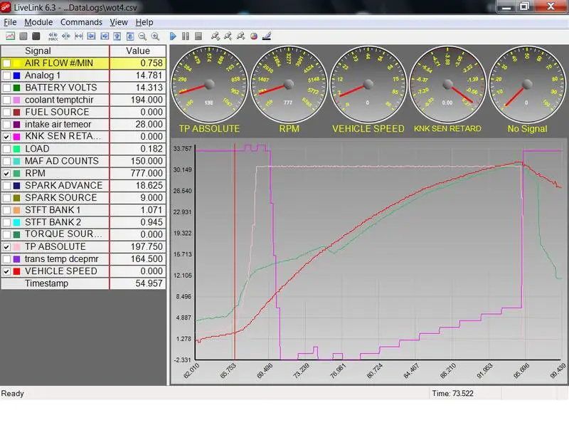

Alt + Prt Scr works great! Thanks for the tip. Below is a section of a past WOT run pulling uphill in 3rd speed before my timing chain components were replaced. Just before accelerating the knock sensor retard was 0. At 2900 rpm the knock sensor retard started to kick in and by 3000 rpm had dropped to -8 degrees.
At 3800 rpm it started stepping back up and had increased to -6 degrees when I released the accelerator at 5800 rpm. Spark advance at 4000 rpm was only 9.75 degrees resulting in a significant loss of power.

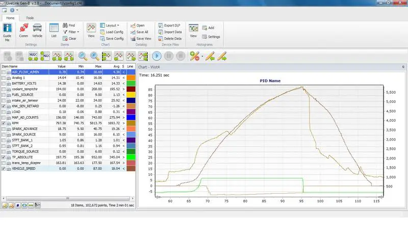

This morning I downloaded and installed the latest available version of LiveLink from the SCT website. Below is a display of the same WOT datalog. I think I like the new version better because of vertical scales for one reason but haven't figured out a way to rapidly move foward and aft to display PID values at a particular time. In the old version just clicking the mouse at any time would move a vertical bar to that location and the PID values were displayed. Now it appears you have to play the datalog and set bookmarks.
Knock sensor retard is the left vertical scale and RPM is the right vertical scale. Vehicle speed shows 0 to 88 mph in 32 seconds (uphill grade all in 3rd speed (2 on transmission selector). I've found for WOT testing an uphill continuous grade pulled in 3rd speed greatly simplifies determining what is going on with the engine. The uphill grade slows everything down as if expanding the time scale. I've done several 3rd speed WOT pulls on a dynomometer and things happen much faster (no air drag on the vehicle for one thing) but a dynomometer is much safer and legal.
