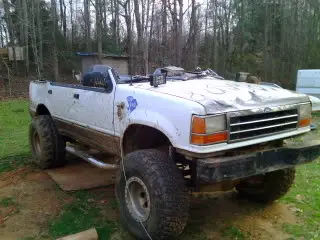

does it not have a roof at all? or a front windsheild? if ya got a pic i would love to see. not many convertible x's out there.
MountainMonkey is offline   Reply With Quote
Old 05-15-2012, 03:17 PM   #7
bigbzc
Simpsonville, S.C.
91 XLT
Join Date: Apr 2008
Posts: 73
Vehicle Specs
(Original Poster)
__________________
'91 Xplorer, 35" swampers and BFG KM2s, custom fabbed 7" lift + 3" body lift
bigbzc is offline   Reply With Quote

wow, chop, cut, rebuild and she'll be good as new lol
