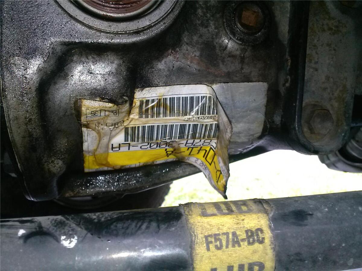

I've suffering from a noise from the front diff...read my post--> http://www.explorerforum.com/forums/showthread.php?p=3018345#post3018345
After all the parts I've changed, I never find out what was causing the noise until last Saturday when my diff committed suicide.
I was driving in the highway and heard a tak! noise from under the car, like when you hit a rock or something hard. Check immediately to the rearview mirror and nothing was on the road.
I parked the xplo outside of a store and when I step out, I smelled the particular diff oil smell....ahhhhhhhhh there was my front diff oil on the parking lot floor!!!
Definitely it wasn't hit by a rock.
First thought it was the axle seal but it was coming right from the sticker the diff has on it. check pics.
When I peeled the sticker I found the crack:mad:

If you are experiencing a noise in your front diff, I recommend a major build up, replace all your bearings.
I ignored the diff carrier and pinion bearings.
I didn't still have time to open my front diff, well it's still bolted in the xplo,
but from where it cracked, I believe one of the pinion bearings went bad.
Will post pics once I get my hands on it.
