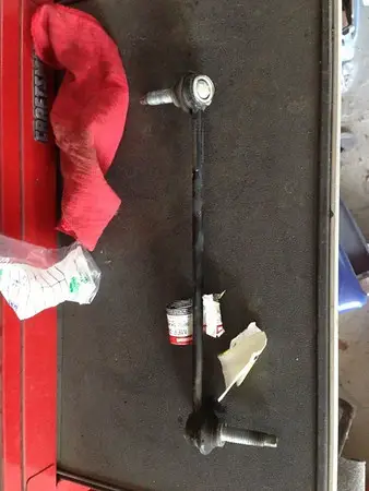

Finally found the source. It was a bad ball joint on the end of the strut that connects the front sway bar to the top of the suspension strut.
I could have had the dealer do this, but it was just easier to do myself. The part was under $30. It took longer to jack the vehicle up/down and remove/replace the wheel than to unbolt the part and bolt the new one in. I was able to use my impact on the top mount, but had to use a wrench on the bottom. The nuts are 22mm, and the ends of the ball joints have a 10mm hex to keep the ball joint from spinning while removing/replacing the nut.
Here's the part. The lower ball joint had a bout a 1/4" of travel in it. Manufacturing defect.

These sway bar end links are famous for going wrong and making horrific noises. The early 2000's F-150's had a problem with them wearing out prematurely. I've replaced several sets.
It is amazing the amount of noise it makes for such a little ball joint. I thought I had some major suspension member that was loose. I went around shaking wheels, looking everywhere - except obviously there, until a week ago.
Really simple fix, thankfully.
My sport makes a strange noise from the front passenger suspension when going over spend bumps, dips or rough surfaces. Only at 1,500 miles so too soon to pin point what it is.
I have actually seen these end links be broken in half on the shaft portion on a couple vehicles. Others, like you say, are just worn out joints.
