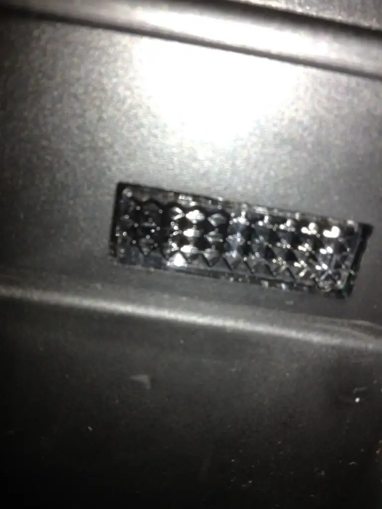

Hello fellow Exploreites, first let me say that I LOVE my 2013 Ginger Ale Limited AWD! I’ve got 1600 miles on her and have a couple of questions for the folks with more experience with their vehicles.
First, the little storage area with the USB ports has what looks to be an LED, but it doesn’t light up. I turned the dome lights on and still no light. Any ideas?

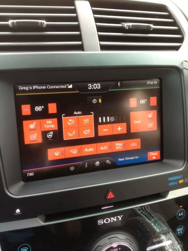

Second, after putting a couple of JPG wallpaper files into SYNC, I now have “red” buttons! I’m not sure why they changed and I can’t find a place to change them back to the original color… Help!

That light only comes on when the headlights are on.
A few others had the screen go red like that after loading pictures, I believe they had to do a reset (fuse pull) to correct the problem

Sure enough, it comes on with the headlights!
Thank you for the response!

Looks like you got a Windows 8 preview installed on your car, lol! I'm not sure what causes that graphics corruption, but I know that one other member on this forum reported seeing the same thing. Unfortunately I cannot recall now it was resolved. I'm sure someone will chime in to help you out

For the second, if the screen stays this way after cycling the vehicle off and on again, You can try a Master Reset. I'm not sure if accomplishes the same thing but that is way easier than trying to squeeze under the dash to pull the fuse. The master reset can be found by selecting the 'Settings' icon to the right of the 'Home' icon. Then select, Settings/System/ Master Reset.
Good luck.
May be easier, but erases all navigation entries, and paired phones. It also has a bug in which it will erase the navigation favorites, but leave the voice tags, so you can't use those voice tags again. I hate the whole "master reset" thing

I had this "orange button" thing happen to me after I put in a USB stick with MP3s on it. You can bring the buttons back to the original black by touching each one. A pain, I know... but easier than pulling a fuse, better than a master reset. Once I did this the orange buttons haven't come back.

Thank you all for the input! I changed my wallpaper to the FORD picture and then starting touching the red buttons one by one, changing them back to a more normal state. Then I got a call and turned the Ex off. Came back 20 min later and all was back to normal.
Thanks again!

Spider, I had the same issue, when I update the wall paper, I get the red buttons, domes yes or no, but found it easier to touch each one, it's a pain.

A Master Reset will change the color back to the proper color. Here are the instructions:
MENU > SETTINGS > SYSTEM > MASTER RESET
Please let me know if you have any other questions, and congrats on your new ride!

I used the touch method and changed them back to the original color one at a time, before I read about the reset... Anyway you guys keep building great vehicles and I'll continue buying them!
Greg
