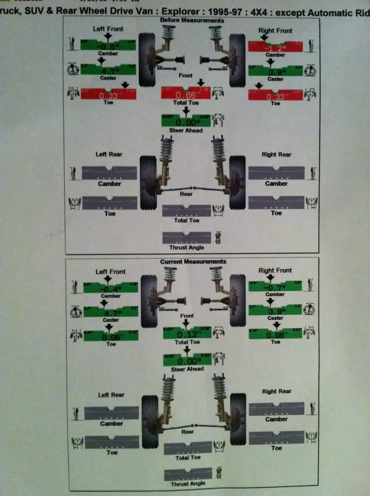

Not sure if this helps but this was the print out of my alignment before and after.

After looking at my tie rod ends it doesn't even look like they were touched...
