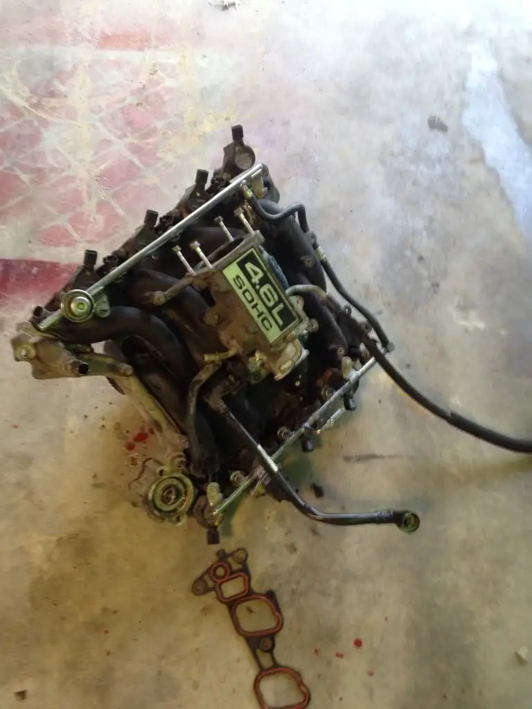

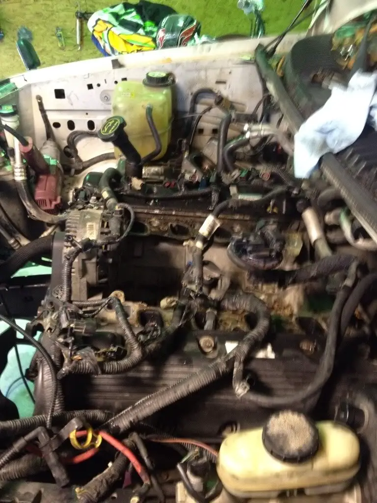

Just a few pics...
Here's a pic of the 5.4 on the floor
The 4.6 in the mountaineer with the intake removed
The intake in the floor

I'm pretty confident in my mechanical capability, but that looks like a HUGE headache. Granted, I've never removed my engine before... But it still looks pretty involved.
It only took about 20 minutes to remove the intake... of course I use air/power tools for almost everything :)

HiImBrian - removing the intake is probably only a 2 on a 1-10 scale of difficulty... no biggie at all.
You just disconnect the wiring to the coils,injectors, sensors and other things on the intake, egr tube, and some vacuum/water hoses, and then remove several bolts and the 8 intake bolts and it's off.
I know that sounds like a lot but I have never worked on a modular motor before and it seemed pretty simple to me??? It would take a lot longer if not using an impact and air ratchet. It does stink to have to remove the intake to get to the two top bellhousing bolts, but I would rather do that and remove them easily than use 3+ feet of extensions and wobble joints and fight it the whole time... just my 2 cents :)

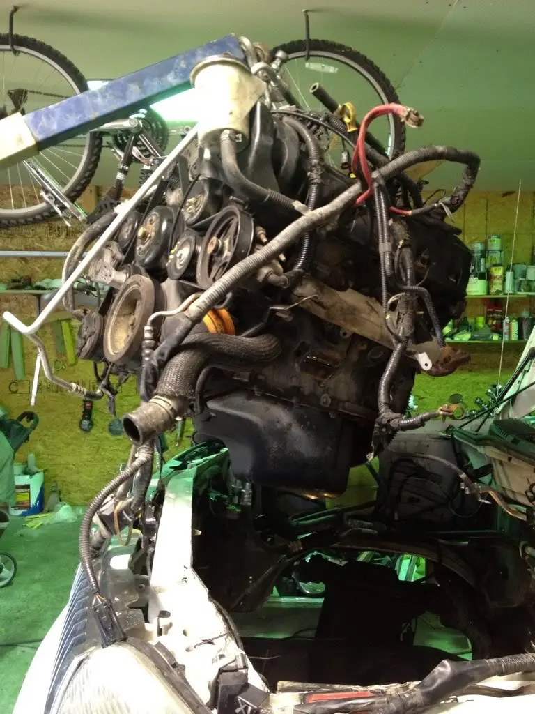

Just an update on progress...
4.6 is out
Something is missing here???
Now on to swapping necessary parts and figuring out flew plate options and what I need. I may have to source a different fly wheel as my 5.4 was out of an Expedition with was I assume was a 4r100 trans. I am going to take some measurement and get it figured out. So far things are going well.
Still excited! The 4.6 looks so little being lifted out of there like that....
