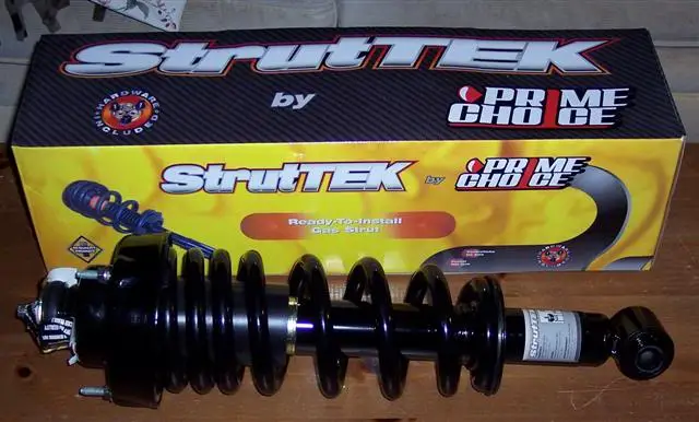

I've been reading a lot of posts on this site regarding replacement struts. I'm looking for recommendations. One side of my Ex sits about 1/2" higher than the other. When I tow, it's like riding a boat, bouncing up & down. Several people seem to like struttek, but I've seen pics and the rears seem to sit much higher than stock. That concerns me. This my DD and and I occasionally tow, but I don't want stiff, jarring ride. Suggestions? Gabriel, KYB, Stuttek, Monrone?

Just did the fronts on my 02 V8 Limited with struteks. Easy to install, and they seem fine on a trip I recently made. NOTE: You can access the nuts on top thru the eng compartment rather than thru the wheel well. After they are loosened a few threads they start to bind, so I used an impact from the top & they zipped right off. Rears were easy when I did them a few years ago. I did compare new & old fronts and they were the same length.

I just did my '03 Eddie on all four corners with the Strutteks. I measured ride height prior to doing the work and after and got exactly the same measurement. All four corners were 3/4" higher until I drove it a little bit and then they all settled back to the original height. They ride nice and were easy to install. Plus they are cheaper and I bought the lifetime warranty so I'm set.

I'm running the StrutTEK's on all four corners and love them. The ride is awesome and the price is sweet. :thumbsup:
